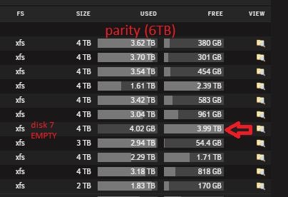

Please see attached screenshot <001> to review the current setup with UnRaid STOPPED

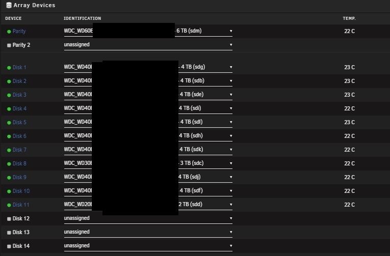

Please see attached screenshot <002> to review the current setup with UnRaid STARTED

01. Add new parity disk - replace current 6TB with upgraded disk
*02. unassign disk 7 (empty disk)
*03. start array and allow new parity to rebuild with disk 7 (empty disk) unassigned / physically disconnect the disk

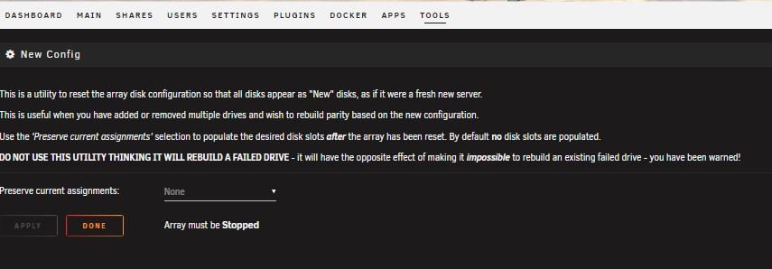

6 hours ago, johnnie.black said:
You can only do this if you do a new config first.
Right. Thank you for your response!
So where would be the spot to run that? I always hesitate on new config as I do not want to lose any data. Need to recall the process.
-Tools -> New Config -> Retain current configuration: All -> Apply
Then unassign the disk you want to remove (you can move the other data disks up a slot if you want), unassign old parity, assign new parity (or just assign new one if old one is already disconnected) and start array to begin parity sync.

First remove disk7 and add the new 10TB disk, then do the new config, after the sync is done you can then use UD to copy the data from old disk7 to the new array.

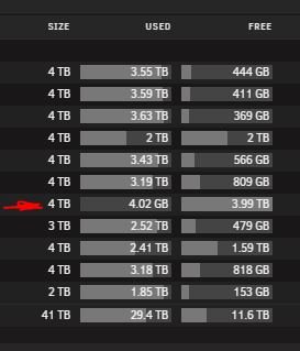

I am making progress and soon to be moving my UnRAID to a new chassis. I have taken a screenshot of my current disk list from the UnRAID GUI so I can match serial numbers to disk slots for reference while i am doing this project.
Before I move my hardware to a new chassis, UnRAID only needs to know via GUI which disk is in which slot, correct?
I don't need to physically hook them up to the same SATA ports during the move? Correct me if I am wrong.

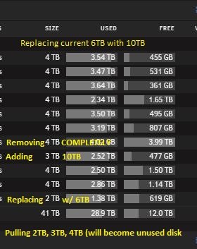

Added note: all disk in the array have been previously precleared, and new disk is precleared. Since I am moving current UnRAID disk and re-using disk that had data on them, do I need to re-run another preclear on the disk I am swaping and re-using?
Current parity = 6TB > replacing with new 10TB precleared
Disk 7 = removing from array physically
Disk 8 = 3TB > replacing with new 10TB precleared drive
Disk 11 = 2TB > replacing with 6TB old parity (was precleared before adding to array in the past)

Switch step 2 and 3 and you should be fine. You can't fully unassign a disk slot until you do the new config. If you complete these steps as written with the swap of step 2 and 3, parity will rebuild with the parity disks assigned at that point. Since you would rather build parity with the new drive, you would save a bunch of time by switching the parity drive out at the same time. Parity has to be rebuilt anyway when you remove a drive, so why do it twice.
So, stop the array, set the array to NOT auto start, power down, do the drive 7 and parity drive physical removal and add the 10TB parity, power up, set a new config keeping current assignments, go back to the main page, assign all the changed drives into their final slots, build parity. After parity is built, then you can do the drive replacements the normal way on the 2 and 3TB drives.

Update: Thank you for your instructions.
10TB Party is in (rebuilding)
4TB (disk 7) is pulled
A quick question, and this is not a big deal.  As disk 7 is non-existent the GUI displays disk 6 and disk 8. Will this always be the case going forward? Is there any way to align disk so they are in order (disk 8 becomes the new disk 7)?
No biggie if not, as it may throw the array out of wack, or may not be able to be adjusted as that's how the cfg is setup.
Thanks,
Edited by bombz
The question not asked is seldom answered.
When you did the new config to build parity, you could have put the data disks in any logical slot you wanted.
Stop the current parity build, do another new config, this time put the data disks where you want them.
BTW, there is a much longer answer if you already have valid parity and want to rearrange things.
The only gotcha for you at the moment could be share definitions that use includes or excludes referencing disk numbers will need to be updated, or any specific disk references instead of /mnt/user locations.
Thanks for the prompt response. I 'canceled' the party rebuild (4 hours in) and ran a 'new config'
I have adjusted the drives accordingly
