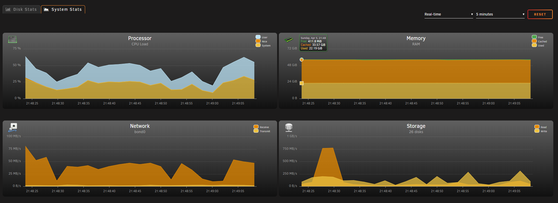

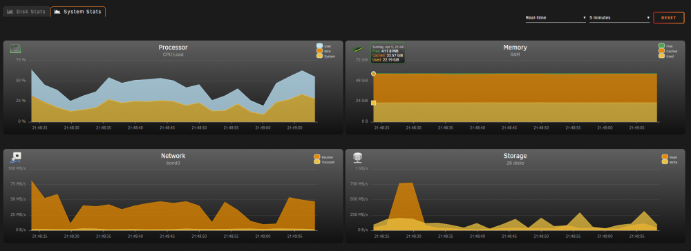

Anyway I got speed like these:
Update the went up after 30min.... to around 88 MB/s still the drives supports Max sustained speed of 210 MB/s
Moving files from a 10T Seagate Ironwolf enterprise "drive 8" to my Cache drive (MM2_SSD_970_EVO_Plus_2TB_S4J4NG0M919326F)

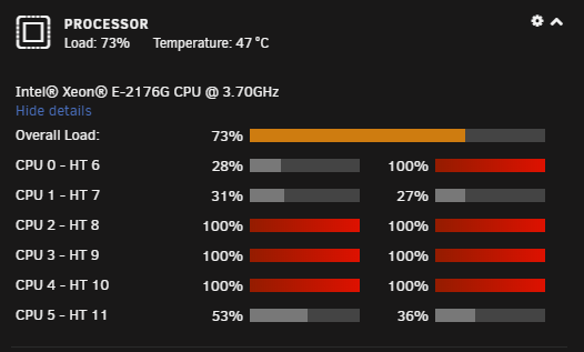

During running the Mover and running all the dockers and 1-2 VM's I can see that the CPU load is pretty high
Also I cant even open the LOG terminal on Unraid during any Mover running? is this normal?

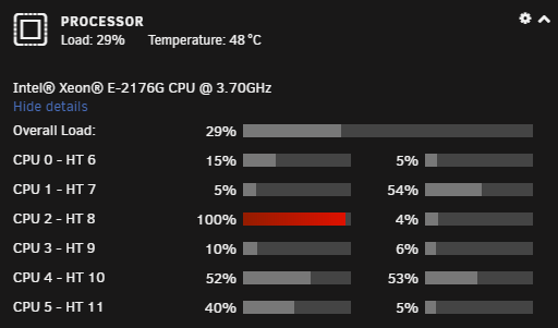

Normal CPU load is between 15-50%:
Update: I think the high CPU is caused by the Plex docker doing Thumbnails and Metadata? (Killing it and things seems to go back to normal)
