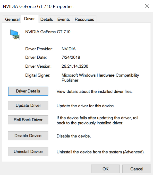

And here is my driver capture from Windows 10 Device Manager

Did you install the driver using the download from Nvidia website or did you use the default Windows driver?
I think it's the default Windows driver which might be why you can get a display without the sound device.
It's still rather peculiar that it would even work though.
Anyway with regards to your xml, you probably will need a vbios to get both GPU and HDMI audio to work (with proper Nvidia driver) since it's the only GPU in your system. SpaceInvader One has a tutorial on how to get vbios so perhaps watch that.
I did both vbios and update Nvidia driver as you mentioned folowing Spaceinvaer One tutorial. Now it works for both GPU and Audio !!! Thanks for your great help to guide me in the right direction to fix this.
