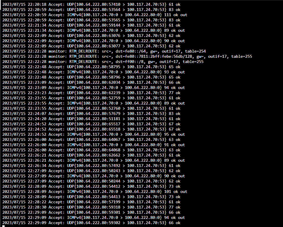

Hello,
I've been looked into tailscale logs and it is constantly logging this
Is this normal? Logs should be somewhat meaningful to highlight issues and not have only same messages in them...
