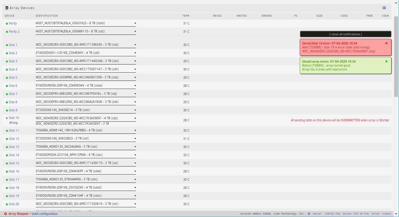

My apologies if this type of issue is already covered by another thread... This is a new one on me and I am somewhat struggling to understand what type of issue i am looking at; therefore best to begin with a screen shot.. then the events..
In short, I previously had a 750GB drive as disk 10 on my array. As I have done many times, I replaced the drive with a 3TB drive which rebuilt successfully. I had carried out the rebuild without the shares mounted therefore shutdown the array and restarted to mount them... my typically rock solid 24x7 system crashed. Any subsequent attempts to restart the array and shares resulted in a crash... start just the array without shares and no crash. A look at disk 10 showed whilst the drive had no data errors, it did have a large number of SMART errors...
So... I once again replaced disk 10 with a new drive... tested error free, this time a 4TB model. The rebuild completed successfully with zero errors, stopped the array, restarted and once again a crash...
Upon the reboot I am now faced with the oddity shown in the attached screen show, Disk10 is in error, status "Wrong", displaying a split line in identification with 1x3TB drive and 1x4TB drive having the same drive ID.
Has anyone seen this and possibly know the cause or more importantly the resolution. I can only hope that resolving this issue with Disk10 resolves the crash issue; either way this issue needs sorting before I look any broader.

Unassign disk10, start the array, when it crashes see if you can download the diags on the console, by typing "diagnostics", then attach here.

It is crashing with Disk10 assigned or unassigned... Would that indicate FS Corruption being emulated? and indeed could that lead to a crash?
Im slowly working through the Reiserfs Drives.
Yes, if there's filesystem corruption it will also be on the emulated disk.
