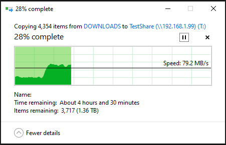

I'm copy over my media library and i'm getting about 30mbps, as shown on the windows transfer screen.  It is being copied from the nas box over to unraid.  Is this normal or should i see some faster write speeds?  When i first started the 1.75tb copy, it was going at around 80-90mbps for a few seconds and then it settled down to 30.

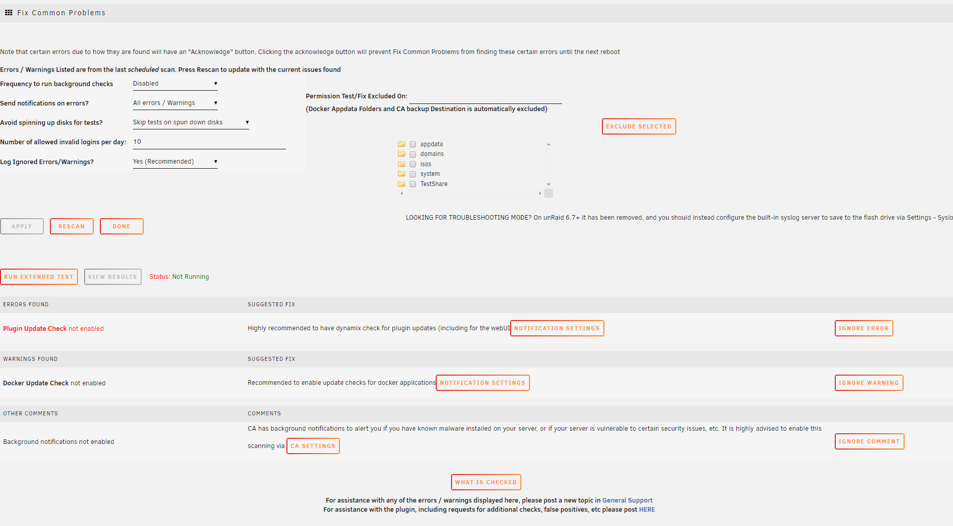

Consider installing Fix Common Problems.  I suspect that write cache may be disabled on those drives which will significantly slow them down (FCP will let you know).  Available within Apps which also means to install Community Applications
Here's what i got from Fix Common Problems.
5 minutes ago, Squid said:
OK  Write cache is enabled so you're good there.

Its been fluctuating from around 75 to 95.  Seem about right?
More or less.  You are using a 2TB Green which isn't exactly the fastest drive around
