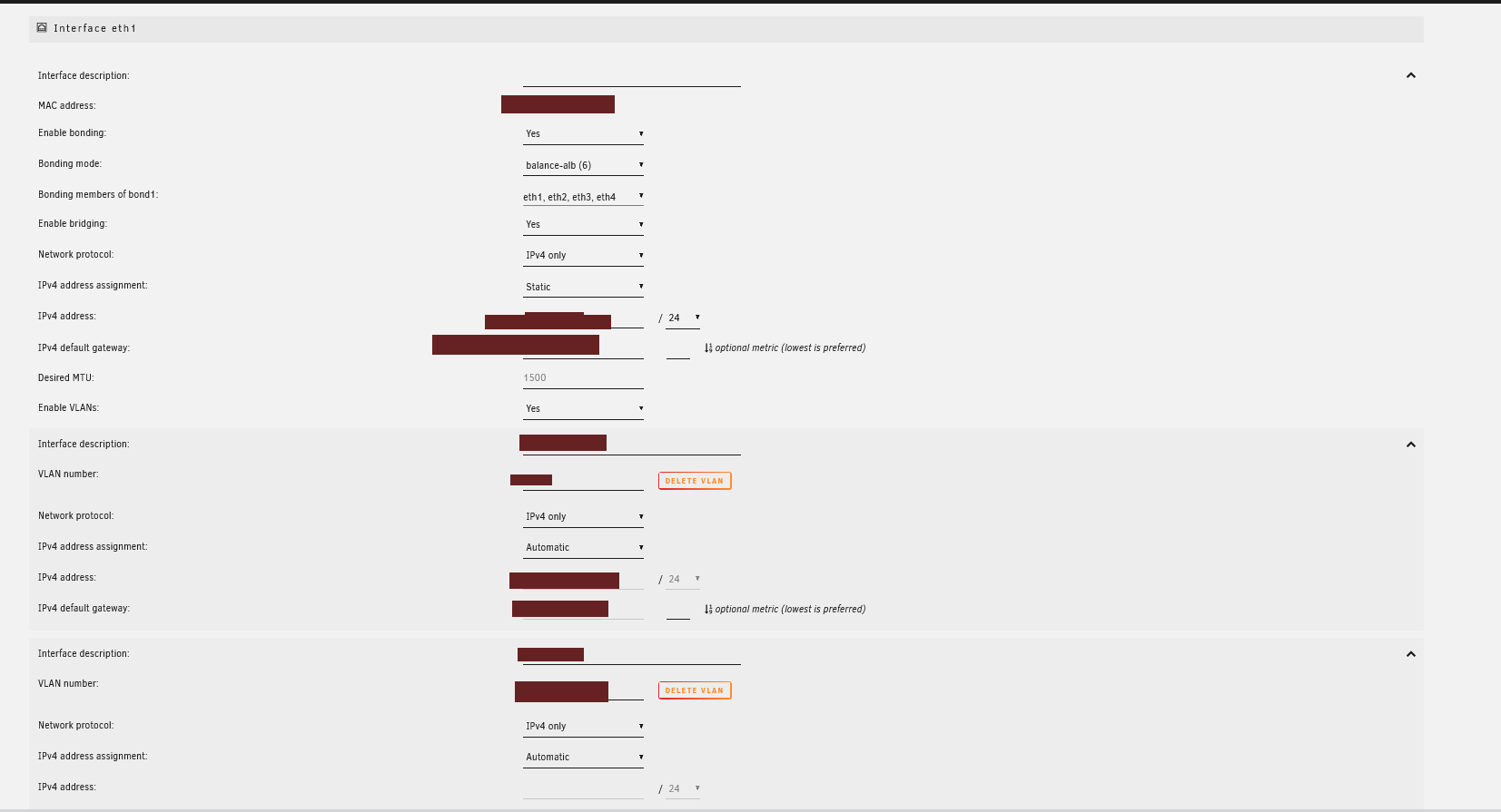

I'm experiencing an issue that I haven't been able to figure out. My unraid instance seems to remember its network setting following a reboot, but either they don't take affect or the routes fail during startup. During boot, it errors out saying something along the lines of "can't find bond1"
I'm running a quad gigabit ethernet nic in a 802.3ad bonding configuration. I've set it to both bonding and bridging.
When I reboot, no network connectivity to or from unraid is possible at first. I have to go into the network settings and change anything on the eth1(bond primary) nic hit apply and then it works until I reboot again.
Any help here would be greatly appreciated.
Thanks
