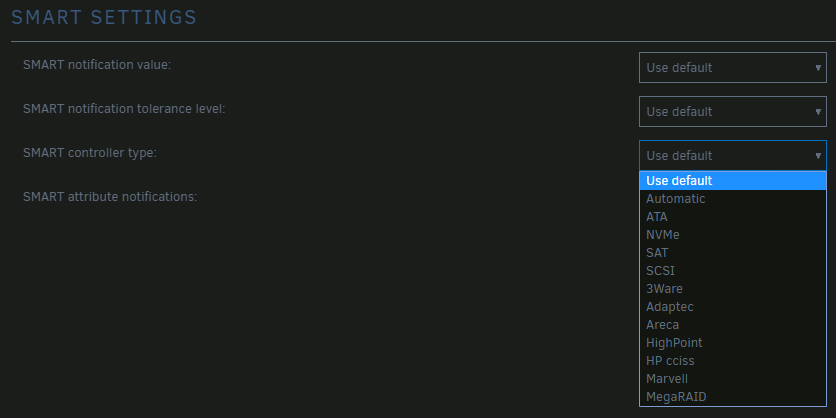

Seems you say problem only happen on Hitachi 8T HDD in SE3016, could you try direct connect those problem disk to HBA or onboard ( bypass SE3016 expander ) ?
Or
Set a wrong controller type for the problem disks
I suspect due to Unraid periodic check HDDs SMART data and this cause expander reset self.
Edited by Benson
