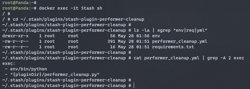

On 6/14/2022 at 2:47 AM, aussie_huddo said:
anyone had any success getting plugins that require python to work? https://github.com/niemands/StashPlugins
Yes
pip install -r requirements.txt, maybe with or without a venv, if a venv then may have to point the plugins exec (in its yml) to the venv's python
I wrote the unraid section of this readme a while ago. https://github.com/com1234475/stash-plugin-performer-creator
may need to follow that if python or something is missing.
edit: Sorry I didnt look at that repo before I wrote that, none of those use a venv. just do this
docker exec -it Stash sh
apk update
apk add git
cd ~/.stash/plugins
git clone https://github.com/niemands/StashPlugins.git
apk add python3-dev
python -m pip install requests
### add the other things to the above command if you want to use that yt-dl_downloader plugin
exit
Edited by sbaak
thanks.
Just to edit that "cd /root/.stash/plugins" neede to be "cd ~/.stash/plugins" for me. I also had to create the plugins folder in appdata/stash/config/

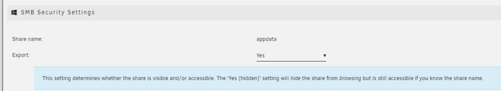

Be gentle. Still an ultra newbie but if my config is /mnt/user/appdata/stash/config how can I access this folder? Its nothing that appears under my shares from my Windows system. How can I reach it? Sorry if its a dumb question. Just trying to figure how to access the folders with the eventual goal of installing scrapers.
The appdata should be a share in unraid, this is where all your docker container presistent storage is designed to go, so you might have
/mnt/user/appdata/strash
/mnt/user/appdata/plex
/mnt/user/appdata/sonarr
etc, etc, etc.
If you want to access it from your Windows system, you will need to toggle that share to be visible on the network, otherwise it will only be accessible from the unraid system.
To do this, go into "Shares" in unraid, and click your appdata share.
Set Export to on, and choose your desired security as well.
You rock! Thanks!
edit: well crud, I see it now but I can't do anything but see it. I'll keep researching though. I had hoped to eventually get some of the scrapers running but its difficult being a linux noob.
editx2: Ah, Dynamix File Manager can do it. I'm gonna get this yet no matter how long I have to beat my head against it.

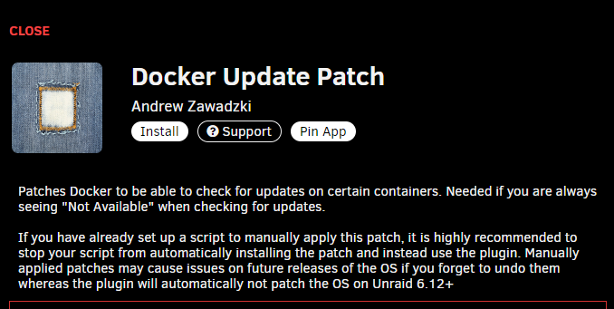

Under "version" it says "Not Available". I have tried reinstalling Stash and I stil get the same message. Any ideas?
Edited by Strubdog
I believe this is missing a /blobs mapping.
Is this added yet?
