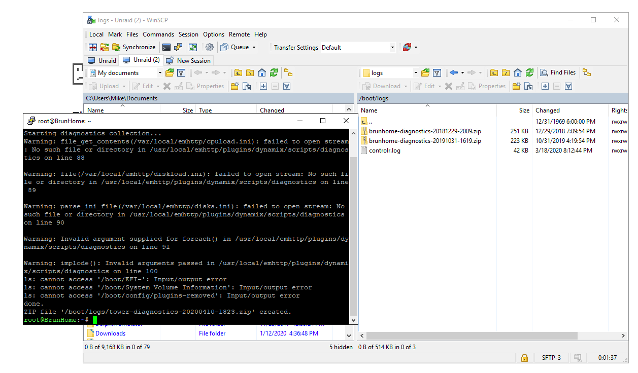

From the command prompt,
diagnostics
and then post the file (stored in /logs on the flash drive) here
Unfortunately it is not showing up in the /boot/logs folder..
That says a lot.  Either the flash drive has dropped offline (reboot with it in a different port), or its badly corrupted and needs to be redone

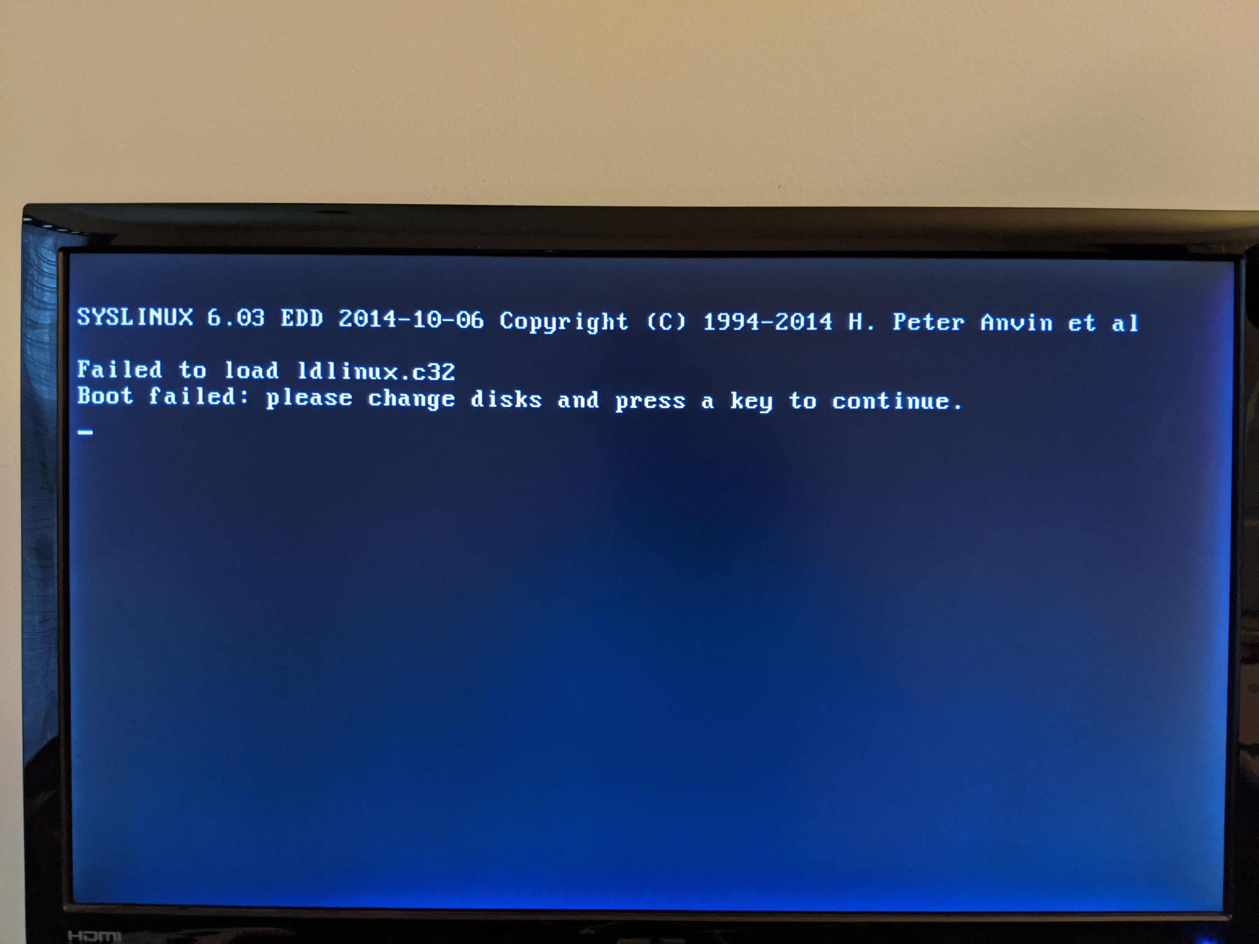

Also, I did a restart of the machine and now I can't get the machine to boot up at all. No access to SSH anymore.. I have added a screenshot above.
Supermicro X8DTL-3F motherboard
You can try running a file system check on it within any of those OS's.  But if you can't gain access, you can't gain access.  You will not lose data on the array if you can't.

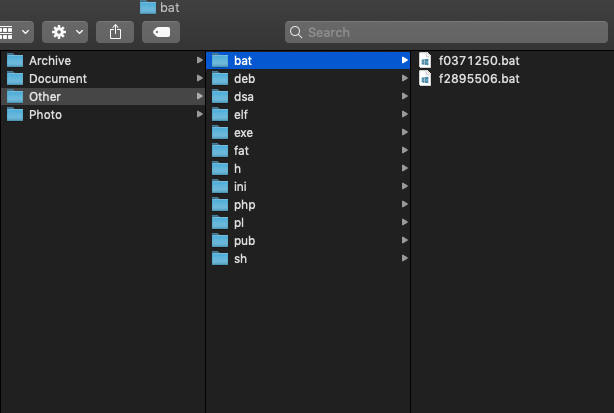

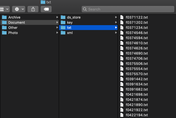

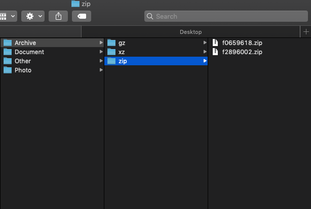

@Squid -  I used Cisdem for Mac and have the following:
Looks like the zip files contain some older setups. Would this be useful for a recovery?
Unfortunately, I can't find anything useful in this format. I'm not sure if it was recovered properly or not. I also have one from October 2019 so a little more recent.

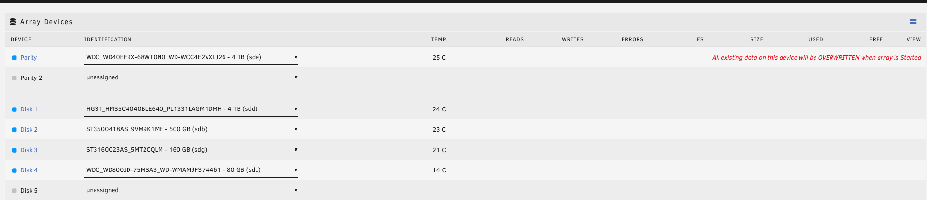

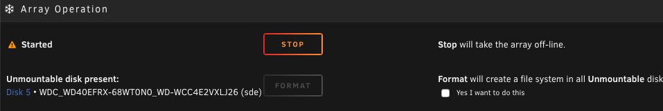

So also put what I think is the parity drive in here as well? Because when I put what I think is the parity drive it shows me this:
Makes me a bit nervous seeing that..
Assign it as a data drive.  If it comes up as unmountable, then it was your parity drive.  The reassign it as parity.

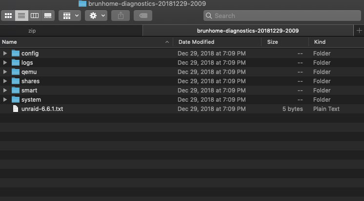

These were your assignments when you last posted a diagnostics (Dec 2018)  Only you would know if this is still valid.
Note that your parity was assigned as parity 2, not parity.  There is a difference.
@Squid - you are correct, it shows up as an unmountable disk
So, I need to stop the array and add the drive to parity 2 then?
Yes.  If you've put the drives into the same positions as the above, then you can check off Parity is already valid.  If you have moved them around, then you have to rebuild parity.

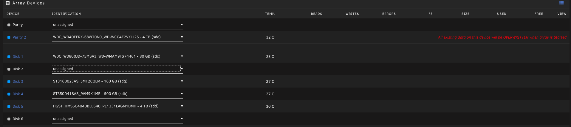

@Squid - I jumped the gun and didn't set them in the same order.. Now it says "Too many wrong and/or missing disks!" when I try to add the parity drive back to "Parity 2"
I found this forum post. Do I want to preserve any current assignments since I've already shuffled things around?
Tools, New Config, preserve all, apply, Main tab, rearrange to proper positions.
preserving assignments is a convenience thing, it just pre-populates the slots so it's less work to assign them if they are mostly correct already.

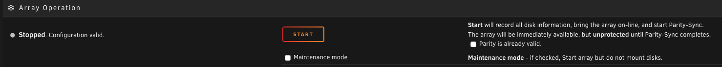

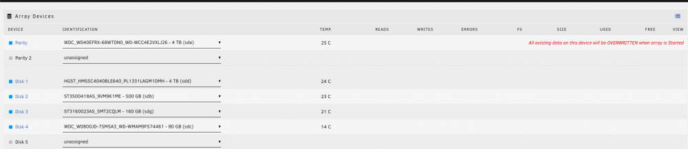

@jonathanm - Do i need to check the "Parity is already valid" option here?
I have added the disks as they were in a 2019 setup. I do not have a disk 2 anymore
I have added my parity drive to parity 2. However, the error on the side saying all existing data will be erased is making me nervous. Is this the right step to do?
I'm unclear. Are you saying the disks are exactly the same as they were right before the flash drive broke or not?
If the assignments are exactly the same, then check parity is valid. If not, you will have to rebuild parity from scratch, which is what the warning is saying.
Unraid has no way of knowing whether the assignments are correct, so by default it will rebuild parity, overwriting that drive. If you tell it, yes, I assigned everything the way it was, then it will assume parity is correct and simply check it instead of overwriting it.
If you want to move drives around to use the parity slot instead of parity2 and change data slot numbers so disk2 is no longer empty you could that now, however parity would no longer be valid and need to be created from scratch. Only drives assigned to parity slots are overwritten though, your data would still be intact.
