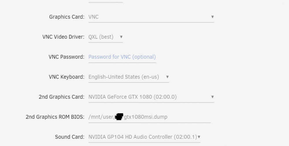

I installed a copy of Windows 10 pro with VNC. Afterwards I added a discrete GPU to the VM like so:
All works and its great, but when I remove the VNC and use only the GPU, I can't connect to the VM through RDP or teamviewer anymore. I can't even ping it.

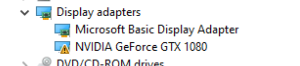

I have tried with other gpu's but it is all the same. I don't mind leaving the VNC installed but I read somewhere it would be better to remove it and also in windows it shows a exclamation mark in device manager.

However in device manager it kept showing up with the yellow exclamation mark and games/tensorflow/boinc couldn't use GPU. So I just decided to put it in my gaming pc and live with the heat.
