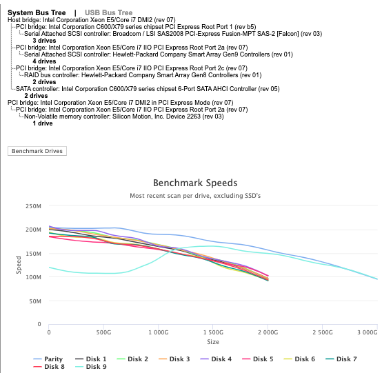

I've run some benchmarking tests via the very nice 'DiskSpeed' docker and, for all my HDDs, I see around 190 - 206 MB/s (see attachment).
What is puzzling is that 'real-world' performance doesn't see transfer rates pushing above 50/60 MB/s even say moving data between my Cache drive (not shown) and array drives (Cache is SSD with over 250 MB/s rate.
Any ideas as to further tests or settings I should be looking at?

That's about right for default write mode, did you try turbo write?
P.S. one of your disks is showing some lower performance on the outer cylinders, is that repeatable?

Thanks for the reply.  The default write mode was set to auto so I've set it to the reconstruct write option (turbo).  I'll run the performance tests again.
