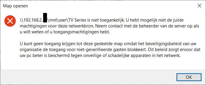

Now I also get this message:
What the h*ll is that for an error...?
Got ya!
I needed to change the setting of Guest Access in the Win 10 Group Policies.
As stated at: https://support.microsoft.com/en-us/help/4046019/guest-access-in-smb2-disabled-by-default-in-windows-10-and-windows-ser
This is my solution:
If you want to enable insecure guest access, you can configure the following Group Policy settings:
Computer configuration\administrative templates\network\Lanman Workstation
"Enable insecure guest logons"
