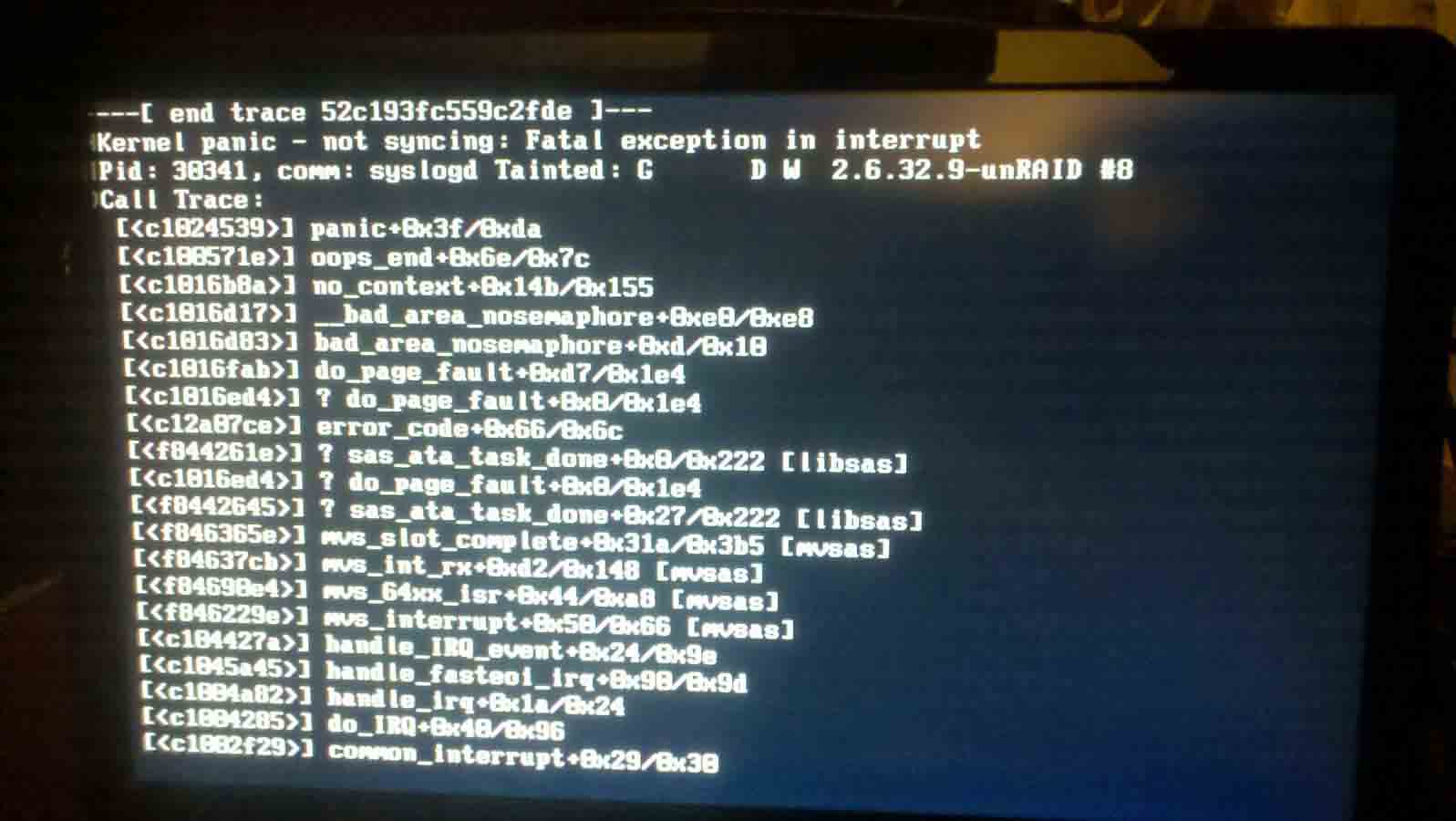

Greetings,
Setting up my first unRAID server.  Installed three hard drives, precleared them, and assigned them (no parity disk yet).  Added two more hard drives, and am trying to preclear those while copying some data to the first three disks.
Got a Kernel Panic.  Took a screen print.
Ran memtest for hours without any issues.
Any suggestions on what to do?

FWIW, I'm still troubleshooting problems with this new server.  I'm trying to preclear all of my drives and the system would mysteriously lock up.  Only once did it crash with a "Kernel Panic" which prompted me to start this thread.
