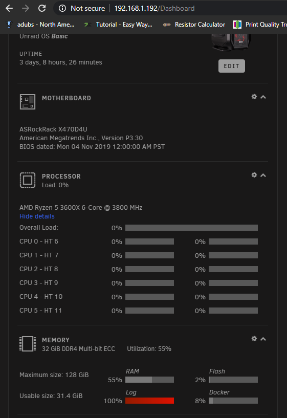

Recently It seems as though something is crashing on my server which then causes a runaway memory leak until log is filled and I have to restart unraid.
I get a lot of:

CPU monitor is dead and log is full

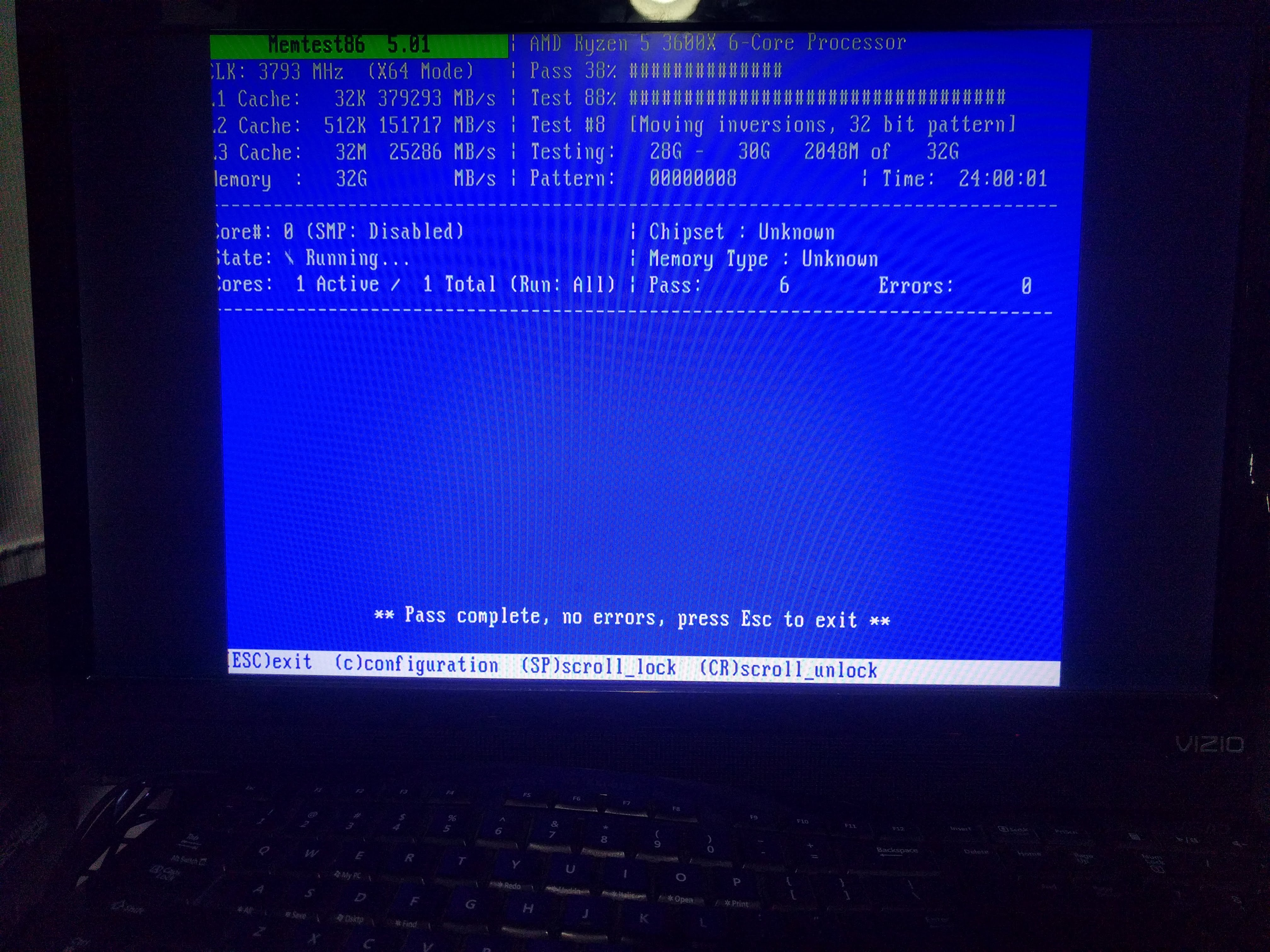

Have you done memtest?
I have not. I did get the memory based on the QVL for the board, and I would think that if I was having a memory issue that I shouldnt be experiencing the same issue with nginx workers crashing out endlessly, and that other parts of the system would also be affected.
At any rate I will run one tonight. What amount of time would you like me to leave it running for?

24 hours is the typical recommendation
I can feel my data addiction withdrawals already.
See you guys tomorrow.
Good news, no memory issues to report.
