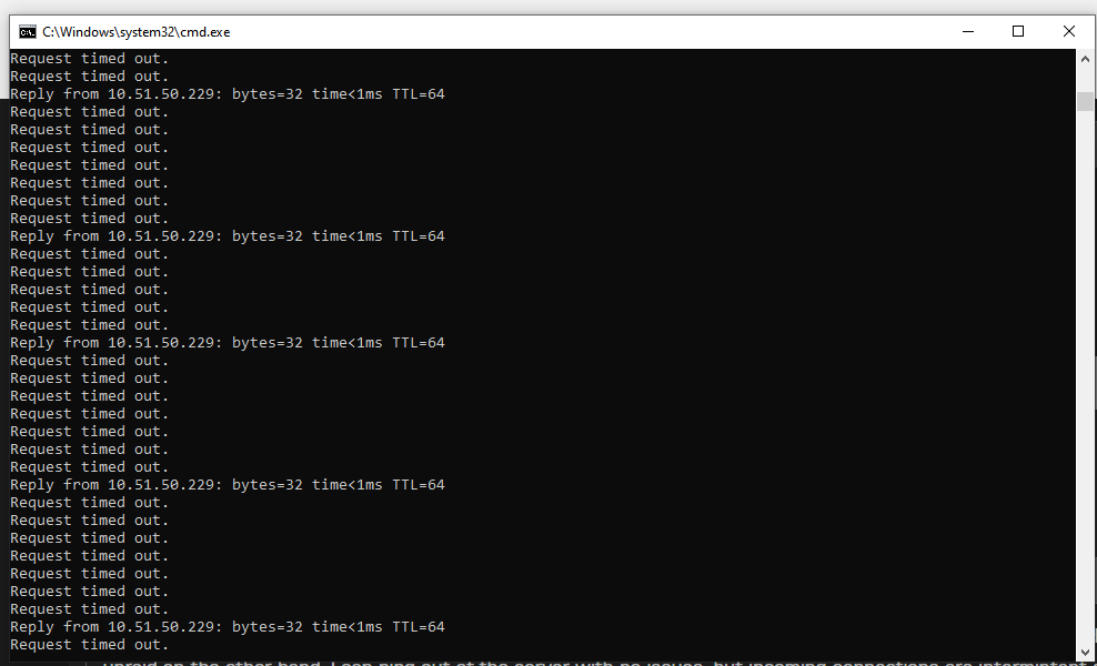

The server responds to pings once every 40 seconds at <1ms - 385ms (this is across a single 24port Netgear switch).  I have tried to put a basic Intel PCI-E NIC in the server and unraid didn't even see the card (other OSs have no issues seeing this additional NIC).  I can ping out of the server two other devices on the network (local Windows PCs) with no issues, but those same PCs can not reach the server more then once every 40 seconds (see attach screen shot).  On the other hand, the server can NOT ping the gateway (my pfSense firewall).  I have found no condition in which the gateway can be reached, nor any device on the other side the gateway (1.1.1.1, 8.8.8.8, etc.).

Well, it would appear that my NICs are dying.  I am now getting the same issue in ESXi.  It didn't start right away, but now that it has been back up for a few hours the system is no longer responding on the network.  Pings are doing the same thing as well.  New motherboard ordered.  Please disregard.
