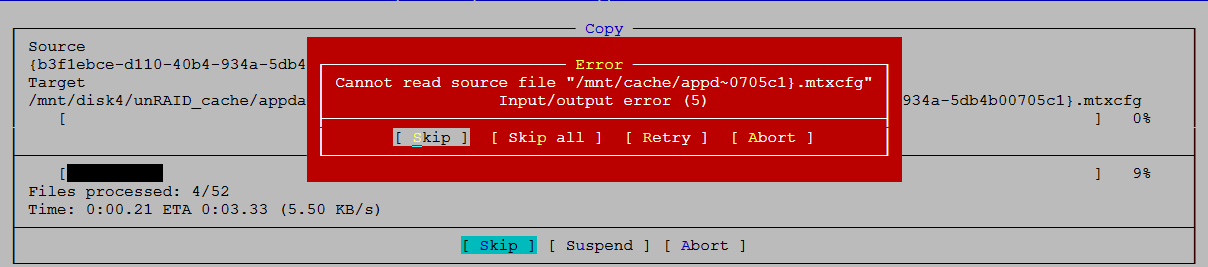

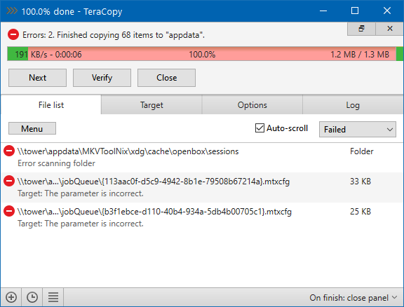

I can access the cache, but copying files usually produces errors. For example, this is what I get when I try to copy \appdata\MKVToolnix to a local drive:
Trying to copy the same folder to /mnt/disk4 on the server via mc on console produces an error in the same place (?):
The other weirdness is that some files seem to go offline and then online again very rapidly, and there's no visible copying progress. Unfortunately I can't seem to capture the Teracopy log as text, but here's a screencap:
Some files do copy OK, but backing up what I can would be almost like trying to copy each file individually and seeing which ones work. So I'm a bit stuck at the moment.
