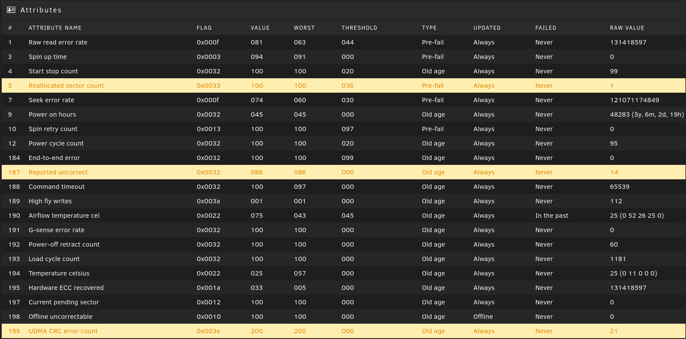

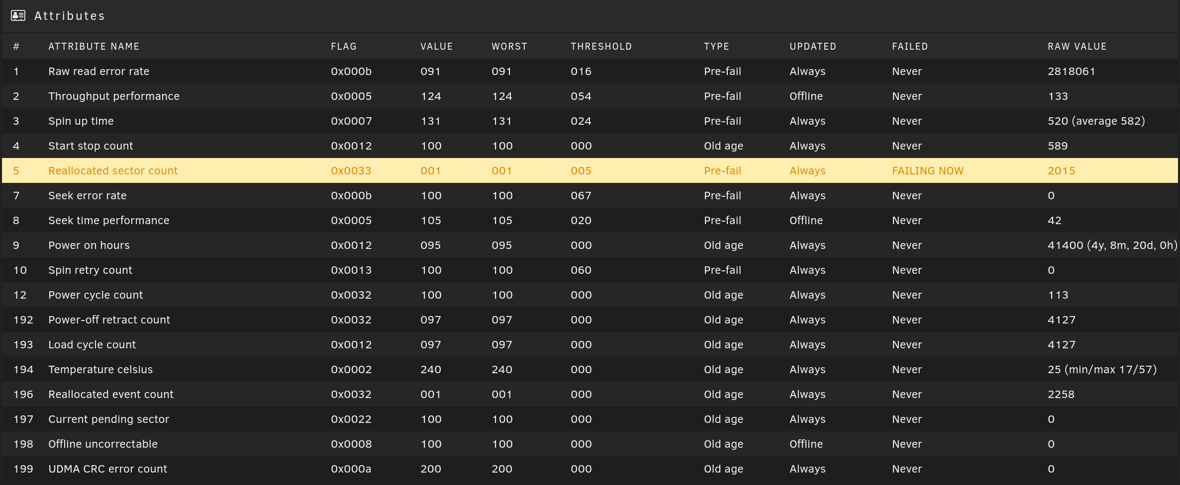

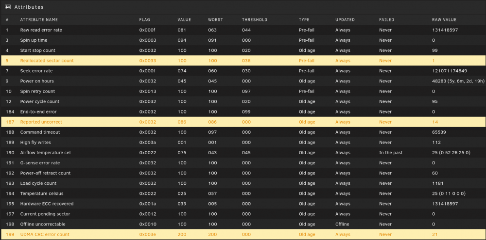

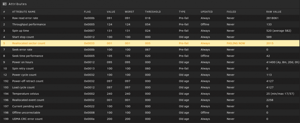

I recently upgraded the entire server, adding RAM, a few GPUs and drives I found laying around the house. I noticed the 2 "new" drives must have been older than I thought. After preclear they both ended up with "Error" status. I figured what the hell, I had a new drives on the way if one failed. Well, one now has the "Fail" status but it doesn't appear to be dead. My first drive still doesn't arrive for a few days (Thanks COVID) but I am trying to figure out if this failing drive, with ~1% of utilization is what is bringing down my entire server.
I've attached the diagnostics (let me know if I did that wrong) as well as the info on both disks
tower-diagnostics-20200413-1819.zip

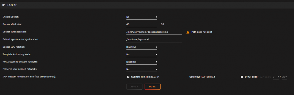

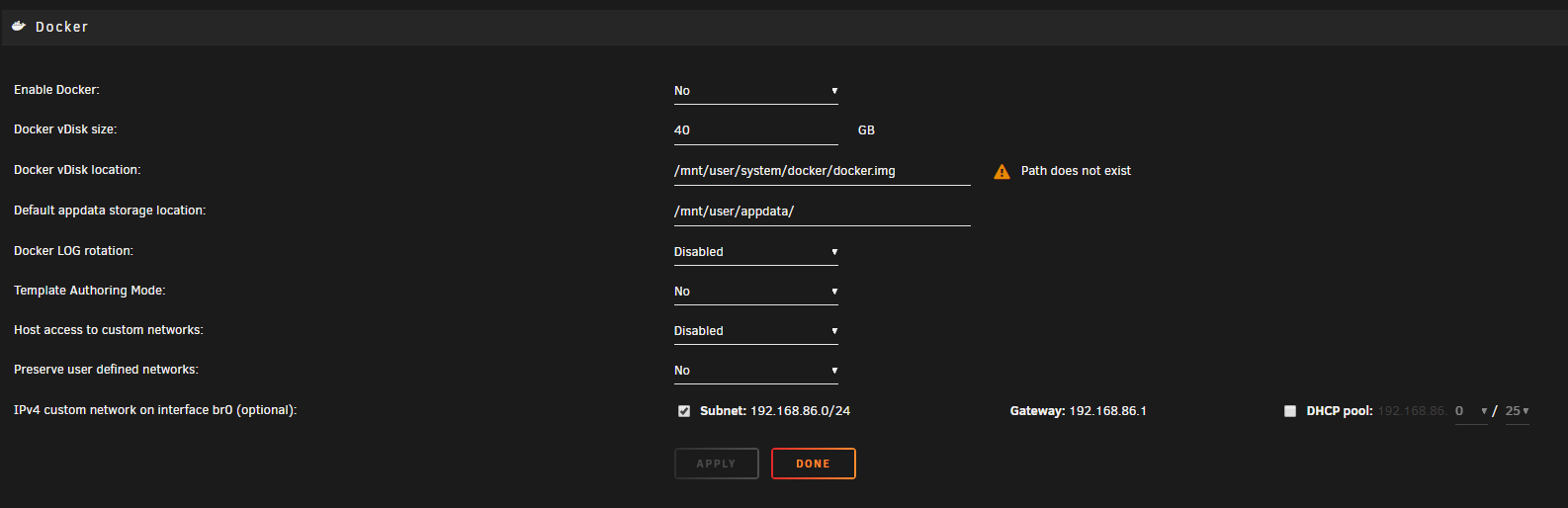

Nothing. Just ran mover and waited. Right after I initially ran the mover when you first had me move the files, the cache dropped to ~400MB, now its back up to 75GB. I don't mind nuking the VMs. I could do that and just set them back up from scratch. How should I have my shares configured regarding cache? All cache-no?
Edited by elpeterson
Go to Settings - Docker and delete docker image. Do the same for libvirt in Settings - VM Manager. Then post new diagnostics.
