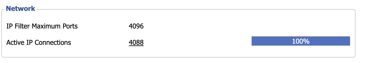

The issue at hand... the last few days Unraid has been taking down my network.
- Few days ago randomly (Wasn't doing anything but transferring files to Unraid. No different than the days prior).
- The internet speed (not LAN) went to shit... restarted routers reached out to ISP still nothing. I then tried to take all the devices off the network but 1 and things went back to normal.. come to find out it was Unraid. Restarted it and things went back to normal.
- Woke up this morning 2 days later and same thing... shit internet (1.2 mb/s). Unplugged the server and it went back to normal (80 mb.s). Plug it back in and it goes to shit. Only a restart of Unraid fixes it.
- So I started looking at some logs on the router.

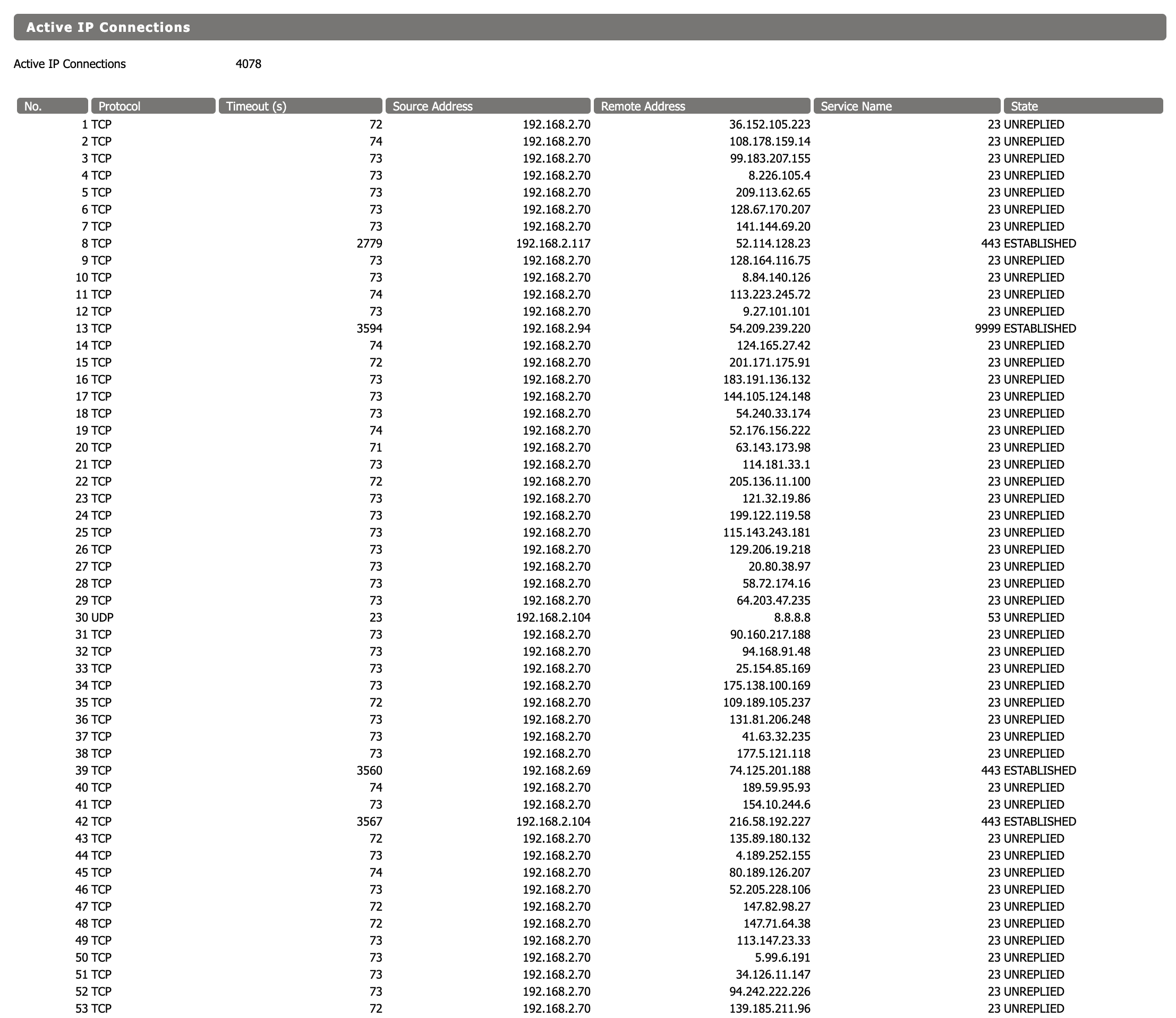

- Had over 4000 active ip connections... (All to/from Unraid).
- I have attached a few screen shots.
- At first i thought it was an external attack. But because it ONLY goes away after unraid gets restarted (Not even the modem/router and getting a new IP from the ISP) it makes me think it's an Unraid issue...

- In terms of my network set up: From the ISP a router/modem that runs the main part of the house then one of the ports is set to a DMZ where i have another router (House out back) that runs everything out here. (unraid, desktops, ect). This way i can do what i need to do out here without effecting the main house. Granted... unraid even takes that part of the network down.
- I'm not sure how to proceed.. anyone have any suggestions?

But, all of those remote addresses makes me wonder if you have put your server on the internet and are being attacked by bots. Your server should only be accessible from your LAN or through a VPN. Have you put it in the DMZ of your router or something?
Nevermind, I misread. Those are outgoing connections.

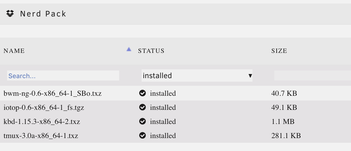

You are loading a lot of packages from Nerdpack? Why?
I installed Nerd pack while following a tutorial to set something up. Granted... I don't remember which tutorial, or what i was trying to set up...
But, all I've needed to do is copy files from one drive to the Array using Krusader.
However, when I go in and look it says I'm only running 4 or so.
Where can i see what you're seeing?
Thanks again for taking the time!
syslog
Seems odd there are so many various outgoing connections from your server. Are you booting in GUI mode and using the browser on the server to access the internet?
No, I boot to the default (Unraid OS) and then access it from computers on the network.

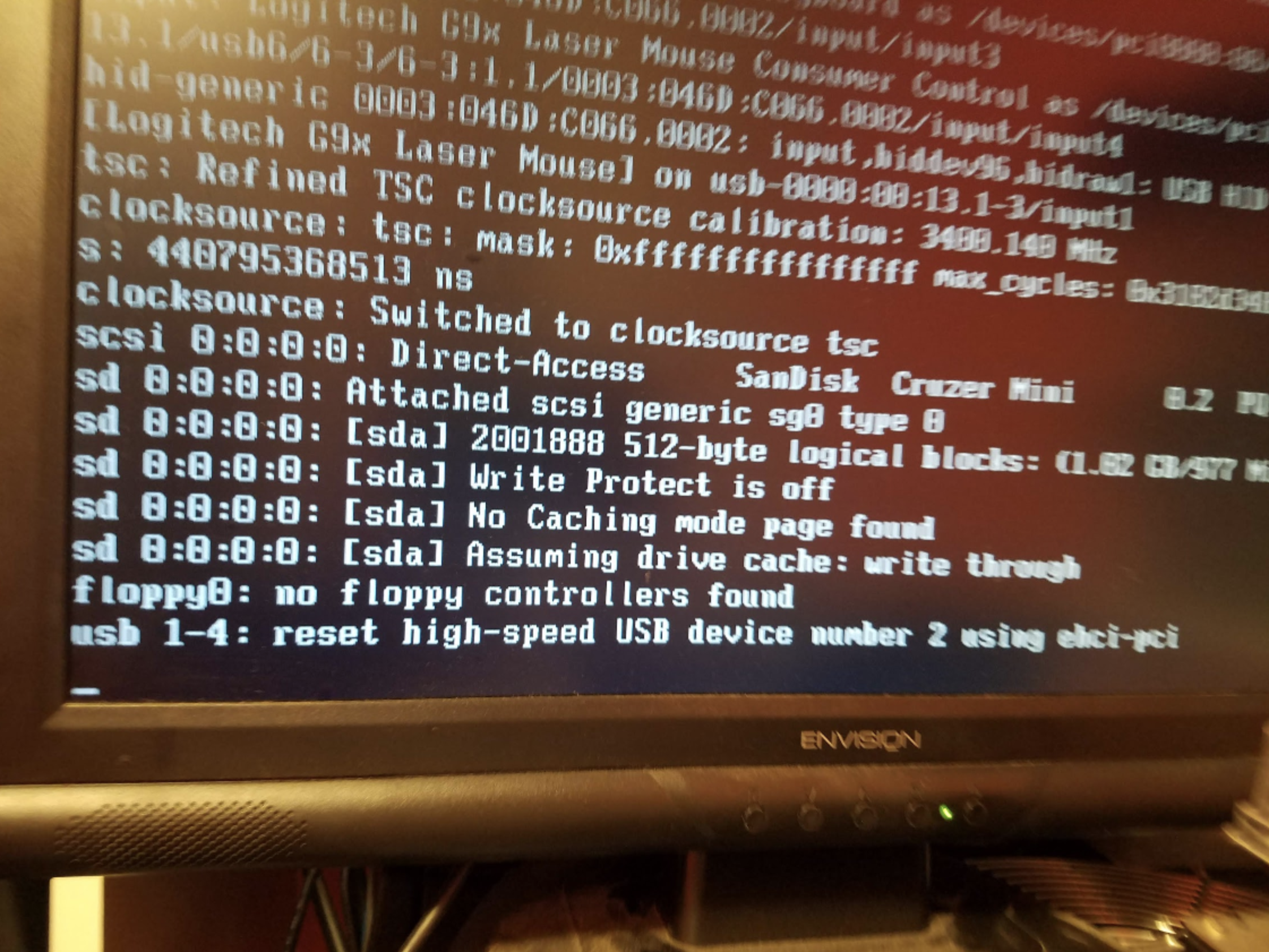

One other issue you may be able to help me w/ is hanging on boot. I was going to post it in a new thread.. but maybe i should just try here..
- When i boot using the USB ports on the back of the MoBo 9/10 it will hang on the following.
USB 1-4: reset highs-speed USB device number 2 using ehci-pci
- When I use the USB ports on the front (So from the MoBo header) it hangs 1/10 times.
- The fix is to pull it out and reinsert it. (Not even rebooting). Then it starts right up...
-Thanks,
You should boot from a USB2 port if possible. USB3 ports seem to lose connection for some. No need for USB3 speed (port or flash drive) for this purpose anyway since it is mostly just accessed at boot to unpack the OS archives into RAM (OS runs in RAM) or to save settings you make so they can be reapplied at boot.
The beauty is... I have no USB3 ports ha. And the USB stick is a USB2 stick (Same one I used for xenology for years). I have more sticks I could try, but unfortunately since i'm on the trail i can only test a new stick when i purchase it. PLUS if it still doesn't work I can only try one more for 12 months. (From my understanding).
