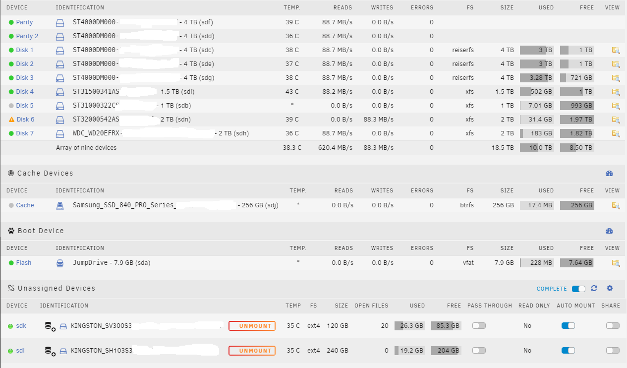

I have been running unRaid for years and have just recently upgraded to the latest version. My drives are all old'ish and most are long out of warranty.  The reason I am looking at replacing the parity drives is because, I  am down to my last "spare" drive which is being rebuilt right now after a failure (disk 6) in the picture.
I run an SSD for cache, docker images (sdk) and VMs (sdl) (just in the process of rebuilding those from VirtualBox vms, but that is another conversation) on the unassigned drives, so the only drives that are "spun up" all the time are SSDs, the standard mechanical drives hold all the data, but they never really spin up unless I'm streaming or doing actual work. So these mechanical drives are spun down most of the time. I have designed this to keep the wear on the mechanical drives to as low as I can and it really helps with the heat that the server throws off.
My setup is attached, anyone have any suggestions about my setup, I would be happy to hear them.
