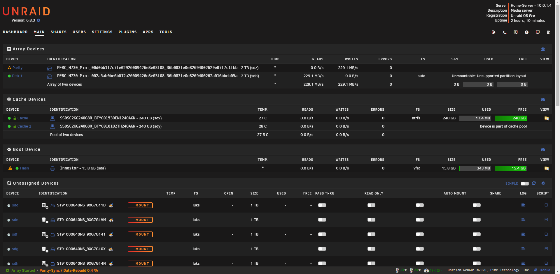

Side note, if I were to create a bunch of raid 0 arrays (2 disks x 12) I would keep my 24 TB pool and still only loose 2 TB for the array. If i put 1 raid 0 as parity and the others in the array, speed should not be an issue then due to the 2x read/write speed, would it be safe to run seeing as there is parity on the raid 0's?
Speeds are now 200MB/s + as you can see in the SS
Edit: Paused the parity, added an iso to the cache and moved it to the array (100MB/s) Now thats still slow for raid 0 but at least it will move faster.
