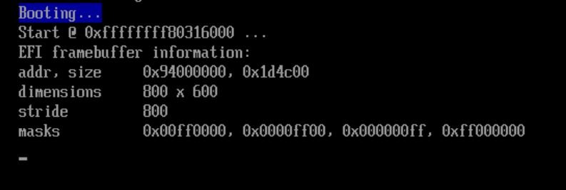

Hello,
I'm trying to install OPNsense (hardened BSD) i've tried seabios/omvf i44 and Q35, nothing works.
Or i'm able to start the VM and i get this to this screen and then it hangs:
Or i can't even save the VM with I44 giving this error:
`XML error: The PCI controller with index='0' must be model='pci-root' for this machine type, but model='pcie-root' was found instead`
My working until frozen config:

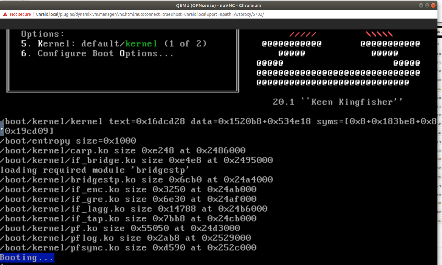

I appear to have the same problem with OPNsense.  Mine fails at this point:
I have tried different OPNsense ISOs (latest and older) and many different combinations of VM settings. After it freezes, the log looks as follows:
