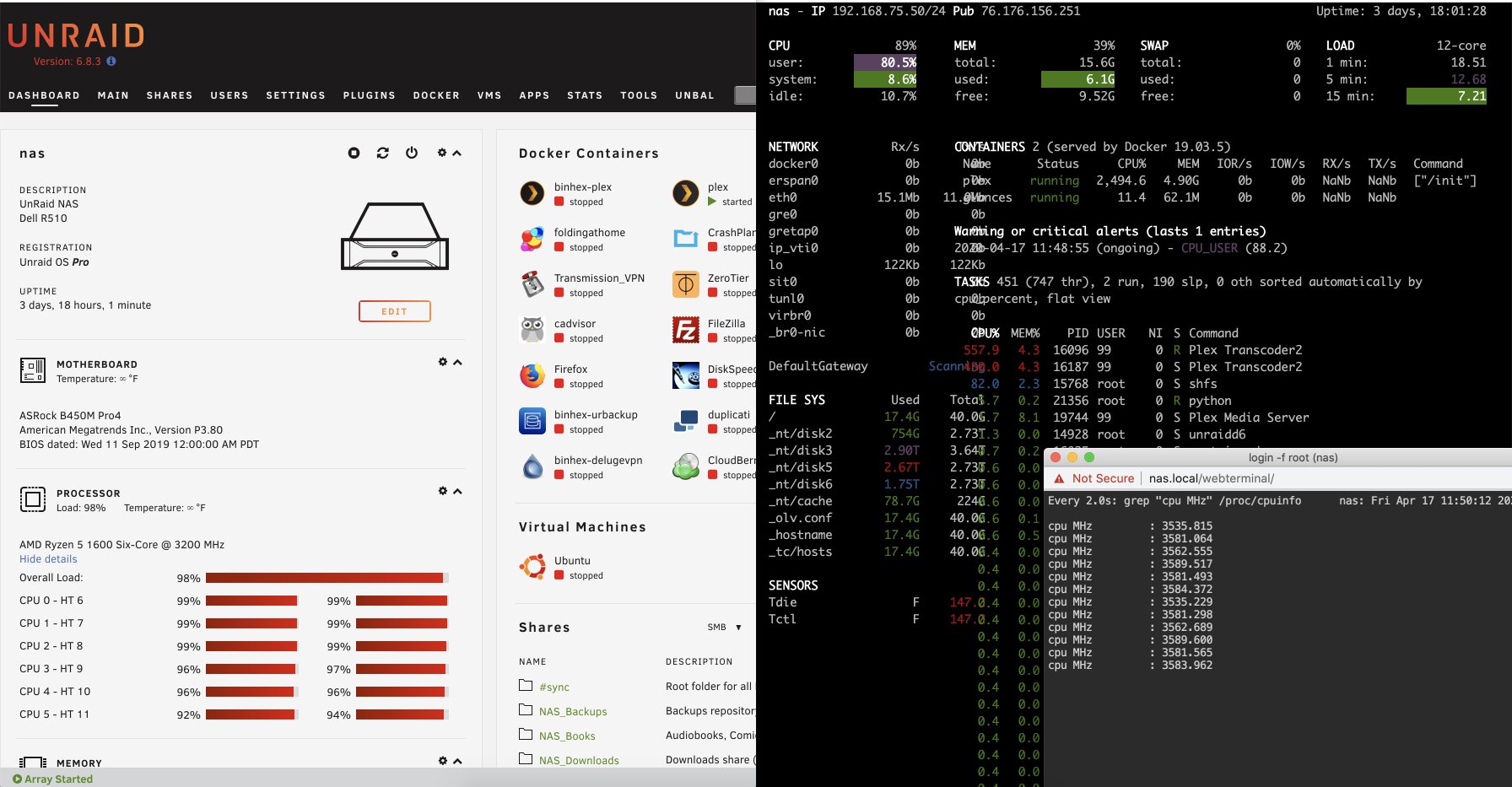

Ahhh duh!  My cores are pretty well used on lots of other tasks..   Honestly I can direct play a probably 2-3 4k streams AND have all my other dockers active , if I try to transcode a single 4k stream then I need to shut down all my dockers except Plex and my procs are all at 100%.  See attached pic.  I think i will create a 720p version of each 4k movie, so that when I am playing remotely the transcode engine isn't pegging my procs.  I limit remote vieweing to 3mbit 720p (only have 10mbit upload speed, grrrrr), and most of my movies are 1080P.  I think the QuadroP400 looks like the best device for me to use, it supports two streams, can handle all transcoding needs for me, which frees up my Processors for everything I ask of them.  Then I can dedicate the older GTX730 to being a GPU for Foldeing@home.
637818685_nasDashboard2020-04-1711-50-12.thumb.jpg.f1bb9f091e5459190949a6b9f3973da3.jpg
Edited by RodgMahal
