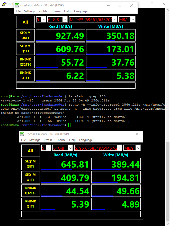

CrystalDiskMark (w10 with direct 10gig line) on M is a cache enabled array share, S is no cache share. Not sure how RAM would have any impact here as under normal use or high disk IO use have never seen it above 50% (128g installed). But tested with 256g and 64 (max of CDM).

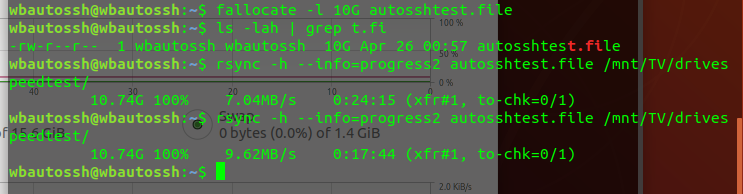

So my testing method was problematic, but there still is an issue. Remote things speed problems seem to be VM based. I know it could be headless but installed desktop version because this is still a relatively new addition and it made testing easier (few months old). I have an ubuntu vm that I manually run
autossh -M port1 -R port2:localhost:22 user@seedbox
(again place that needs to be automated eventually, but unraid server is not rebooted often). The VM has movie and tv shares mounted from the vm options in unraid. The vm can still access all server shares, so the whole point of doing it this way for security is not good but better than the unraid server itself making the connection (and the hassle of getting autossh running on unraid again). On seedbox side I have
sshfs -o reconnect,ServerAliveInterval=15,ServerAliveCountMax=3,cache_timeout=3600 [email protected]:/mnt/TV/ /home/user/RazaTVdir/ -p port2
 and a movie share command. Internet is 200/20, and sonarr would import via this tunnel at ~80mbits previously, which I'm now thinking might have been the VM limiting it not a sonarr limitation (base on the ~10mbs speeds below). Older method (before vm) was to manually download files with desktop with ftp/filezilla which would get ~170-220mbits with 220 pegged if using segmented and parallel downloads. [I know 10g is small here, but this vm is on a vm ssd which only has like 30g free.]
Seeing other posts about br0 being an issue with some VMs speed, but there was not a network spike during test (why monitor is behind terminal). Rebooted the vm and tested again with a speed of 6.80 so about the same. Not sure that this would be a br0 issue tho as I used to get 80mbits/10mbs, and now i get 20mbits when lucky, most the time 5 to 10. Using desktop/ftp I get the same speeds from seedbox, but ssh tunnel thru vm is slow.
