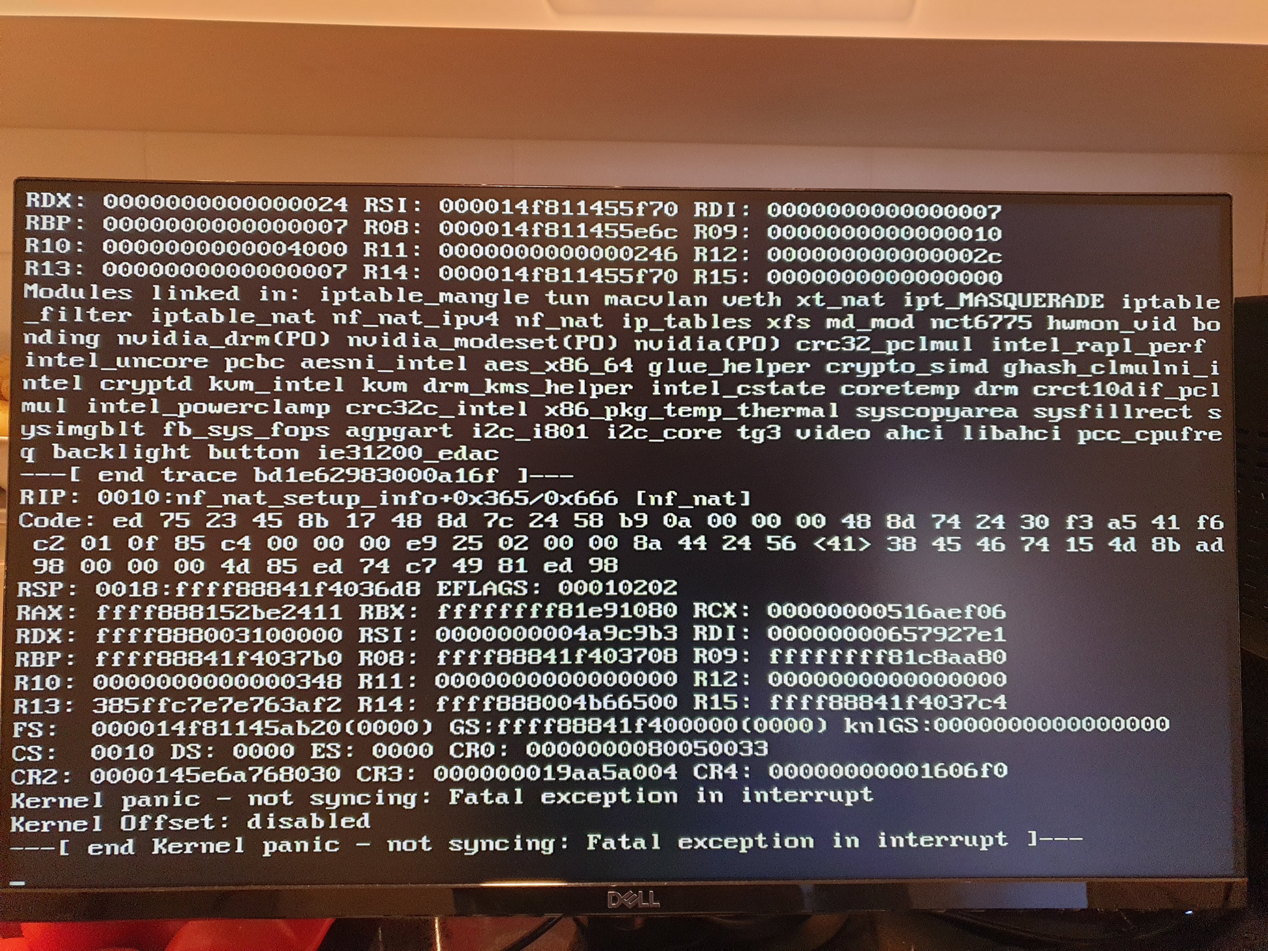

I've just experienced another server hang and have had to do forcefully shut the server down and restart it. I managed to capture what was on the screen at the time which I've attached along with my diagnostics. Currently doing another parity check but cache pools seems fine this time.

Logs are after reboot so they don't tell what happened.  You should turn on syslog server.
Probably not related, but you should check the data/power connection of your cache2 drive.  Its throwing what looks like connection errors shortly after booting.
Best course of action now is to run the official unraid (not the nvidia build) to rule things out.  If it still hangs then try "safe mode" which disables all the plug-ins.  That will further narrow it down.

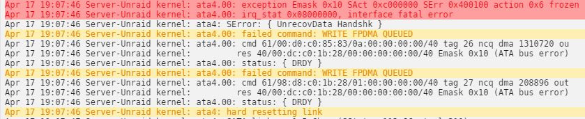

Are you able to let me know which device is causing these errors (ata4?)... is this cache2?:

you can generally find it in the syslog early on in the boot process:
Apr 17 17:45:27 Server-Unraid kernel: ata4.00: ATA-11: WDC  WDS500G2B0A-00SM50, 193163803750, 401000WD, max UDMA/133
here is shows WDS500G2B0A-00SM50 as being connected to ata4.00
further down in the log you'll see
Apr 17 17:45:27 Server-Unraid kernel: scsi 4:0:0:0: Direct-Access     ATA      WDC  WDS500G2B0A 00WD PQ: 0 ANSI: 5
Apr 17 17:45:27 Server-Unraid kernel: sd 4:0:0:0: Attached scsi generic sg4 type 0
Apr 17 17:45:27 Server-Unraid kernel: sd 4:0:0:0: [sde] 976773168 512-byte logical blocks: (500 GB/466 GiB)
Apr 17 17:45:27 Server-Unraid kernel: sd 4:0:0:0: [sde] Write Protect is off
Apr 17 17:45:27 Server-Unraid kernel: sd 4:0:0:0: [sde] Mode Sense: 00 3a 00 00
Apr 17 17:45:27 Server-Unraid kernel: sd 4:0:0:0: [sde] Write cache: enabled, read cache: enabled, doesn't support DPO or FUA
where the sd 4:0:0:0 refers to this ata4.00.
Finally, towards the end of the boot process you'll see mdcmd list all of your drives in the slot assignments and you'll see the cache there
Apr 17 17:46:07 Server-Unraid emhttpd: import 31 cache device: (sde) WDC_WDS500G2B0A-00SM50_193163803750
where slot 30 is cache1, slot 31 is cache 2, and so on.
That just an example of how I found out whats going on. There are obviously different ways as well.
I hope that the docker issues fixes your hangs, just need to figure out what is going on with that cache2 drive.  If you have any available sata ports, you can try them, or swapping out the cable again.

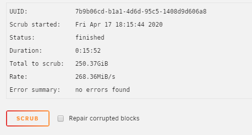

I did a scrub on the cache pool and it gave me this which I forgot to mention in my previous message
It's doing a parity check now so I will swap out the cable after and hopefully that along with the other changes I've done (with your help) will solve the issue of hanging :) thanks
That looks promising thus far. Hopefully the cache pool remains intact while you figure this out.

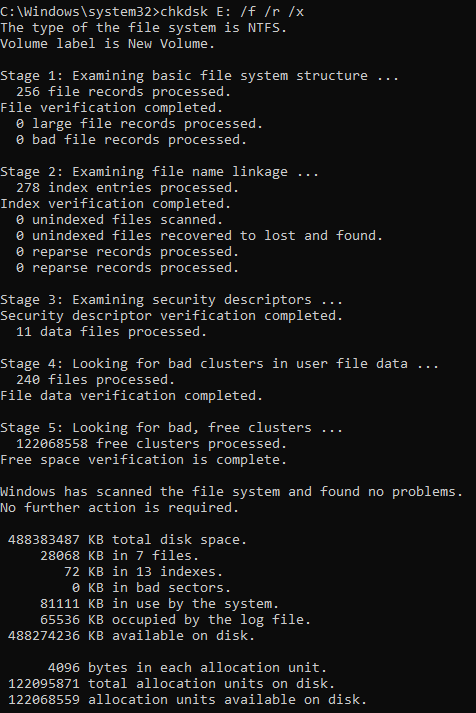

  • Plugged cache2 disk into my Windows 10 PC and ran chkdsk and SMART scans - drive seems to be healthy (I have ordered another drive just in case and it will arrive on Tuesday)

Chkdsk info for cache2:
