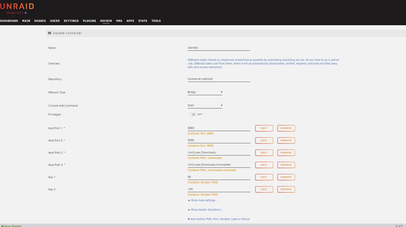

For host path 2
/mnt/user/Downloads/
for host path 3
/mnt/user/Downloads/incomplete/
But there is nothing in those files/shares.
root@localhost:# /usr/local/emhttp/plugins/dynamix.docker.manager/scripts/docker run -d --name='sabnzbd' --net='bridge' -e TZ="America/Los_Angeles" -e HOST_OS="Unraid" -e 'PUID'='99' -e 'PGID'='100' -p '8080:8080/tcp' -p '9090:9090/tcp' -v '/mnt/user/Downloads/':'/downloads':'rw' -v '/mnt/user/Downloads/incomplete/':'/incomplete-downloads':'rw' -v '/mnt/user/appdata/sabnzbd':'/config':'rw' 'linuxserver/sabnzbd'

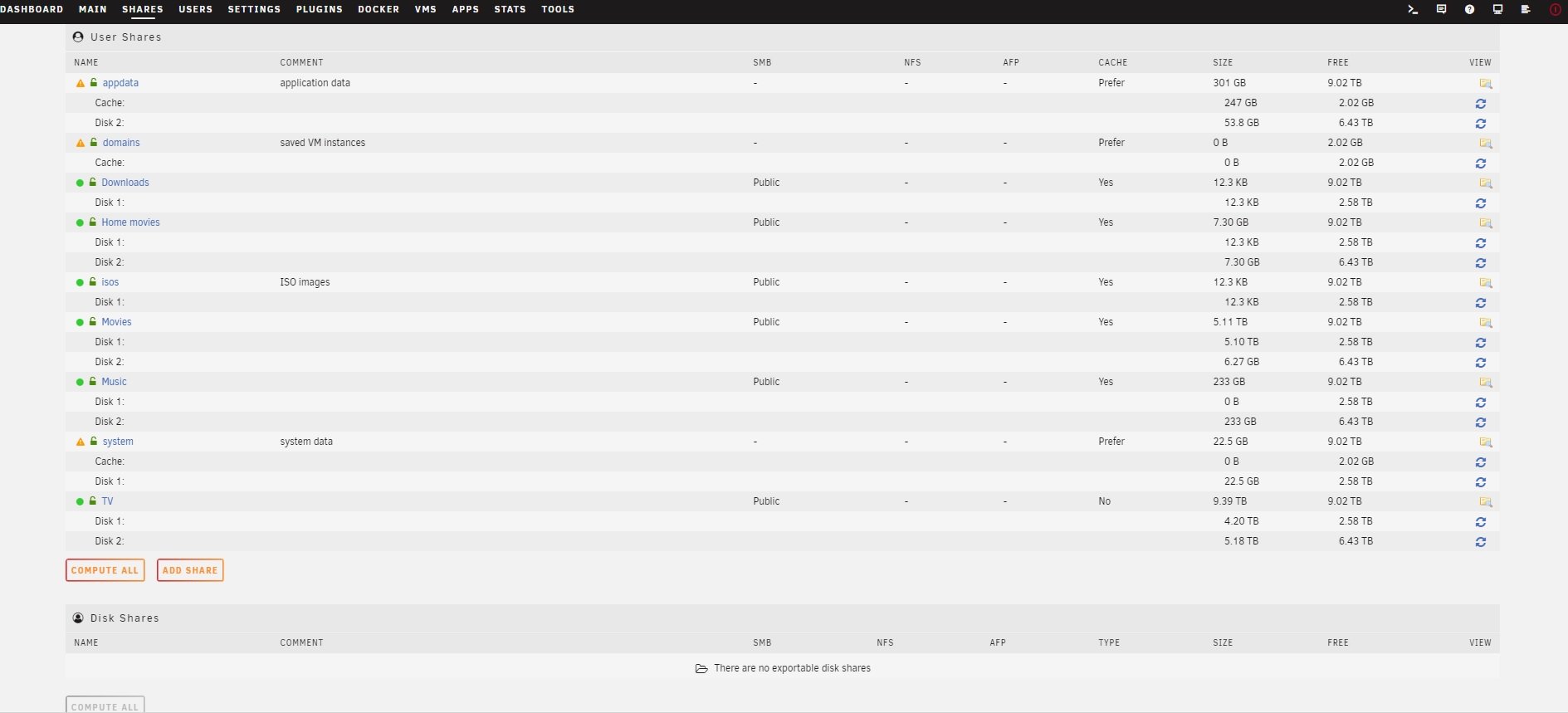

From the Shares Tab, can you hit "Calculate" and then post a screenshot so we know which share is causing this and how much
Here is screen shot.   Thanks, let me know if  you see the issue.

According to your diagnostics, only appdata, domains, and system shares have anything on cache. Could be your downloads are going into appdata. And this last screenshot you just gave makes me think you are downloading into appdata.

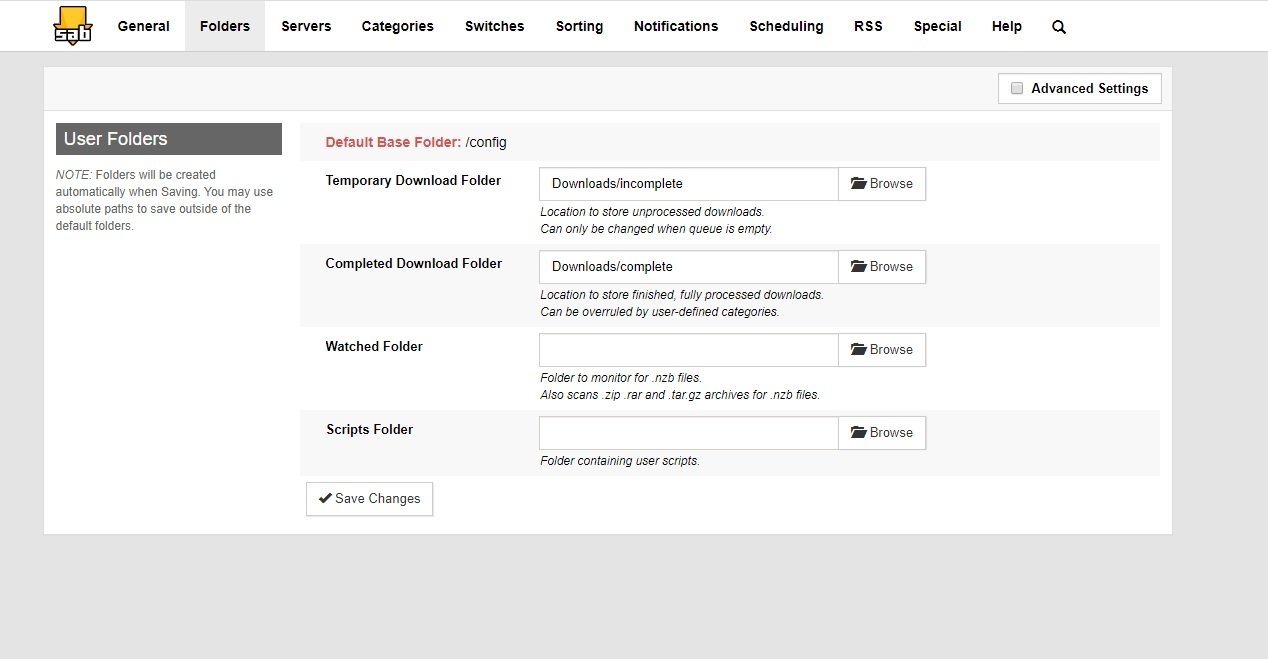

Give us a screenshot of the folder settings for SAB.

Yes, I mis-typed.
 The share is Downloads with a "D"  not a "d", but the entry in sab is with a "D" so I do not think that is  the problem, I just mis-typed here.
Yes, the problem is a full cache, I am attempting to move it to the proper folder but it is not moving.

You missed what @trurl said.  The appdata share is taking up 247Gig right now.  Only a few reasons I can think of OTOH, and the primary reason is what he said.  Your downloads (or incomplete downloads) are being saved to /config/incomplete or /config/downloads and the like within Sab.  You can tell that within it's settings.
Easiest way to make this mistake is within it's settings for where to download to (incomplete) or move to (complete) is to specify downloads instead of /downloads.  If you look at the top the Sab's screen it says relative folders are based off of /config.
(and unrelated and should be fixed later is that your docker.img file is sitting on the array instead of the cache drive)

This last screenshot isn't what I asked for. It is only showing the same information we already got from your docker run you posted earlier.
What I was asking for was the folder settings WITHIN the application itself. Likely you have exactly what Squid suspects:
If you told SAB to download to "downloads" instead of to "/downloads", then it is going into a subfolder of "/config", which is mapped to your appdata share.
I just found...
Index of /mnt/cache/appdata/sabnzbd/Downloads/complete
That is where my files are.
I find this by clicking explore on cache disk from "Main"
Note, files are in Downloads/complete
There are supposed to go do share /Downloads but they did not.
When  I go to mnt in krusader, I can not see a cache share or folder.
Any thoughts?
Edited by Renew
5 minutes ago, Renew said:
I just found...
Exactly what we were saying. You have the settings WITHIN the application wrong. You must be telling it to download to "downloads" instead of to "/downloads".

This screen shot...
This appears to be the problem, why is default folder config? and how do I change?

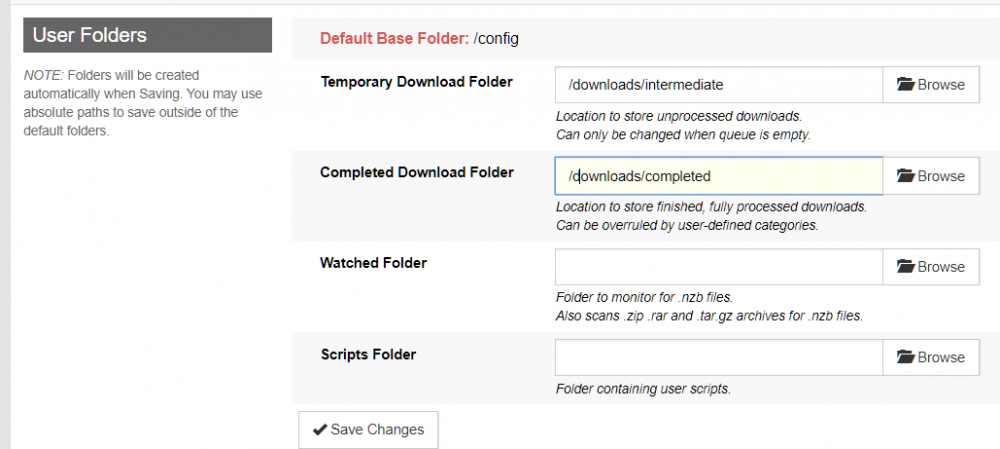

Because of

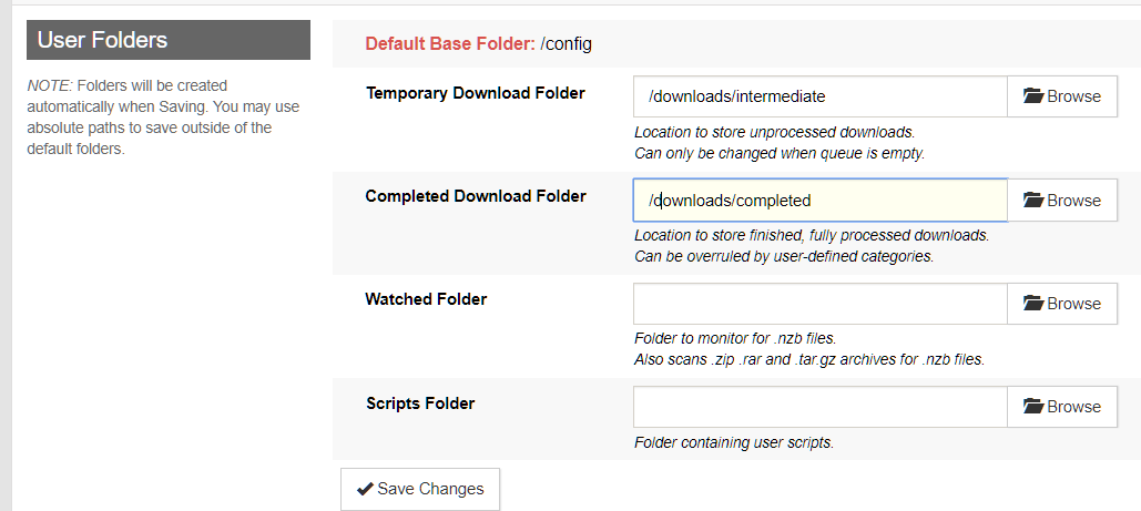

Although in your particular case your should in Sab's settings tell it to download to /downloads.  Right now it's set to Downloads
ie: it should look like this
Because the default way of setting up Krusader specifically only includes "Shares" (/mnt/user) and not all the disks and shares (/mnt)
Look at the Slashes.  And the note on the left.  You're not using absolute paths (ie: no leading slash) so Sab tells you that it's going to be saved within /config (ie: /mnt/user/appdata/sabnzbd...)  The leading slash makes it an absolute path
Oh, and don't just add a slash to what you've already got.  The lower case as I posted is what you want based upon your docker run command.  If you just add a slash, it'll be saved into the docker.img
Confusing as hell.  Yes.  But, if you review @SpaceInvaderOne video on docker basics, it'll make sense.  It's one of those concepts that you can't adequately explain until you understand it, and once you understand it you can't explain it (if that makes any sense)
