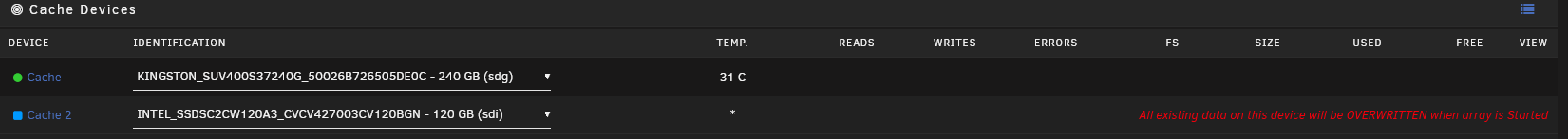

Update: now unraid detects the drive but get the fallowing warning (picture)
How cand i force unraid to use this disk as part of an existing cache drive?

Update: now both drives appear as new drives and the pool was raid 0, is there a way to make unraid assign them again without the loss of data?
Update2: After a few restarts the pool was recognized and started succesfully.
Problem solved.
