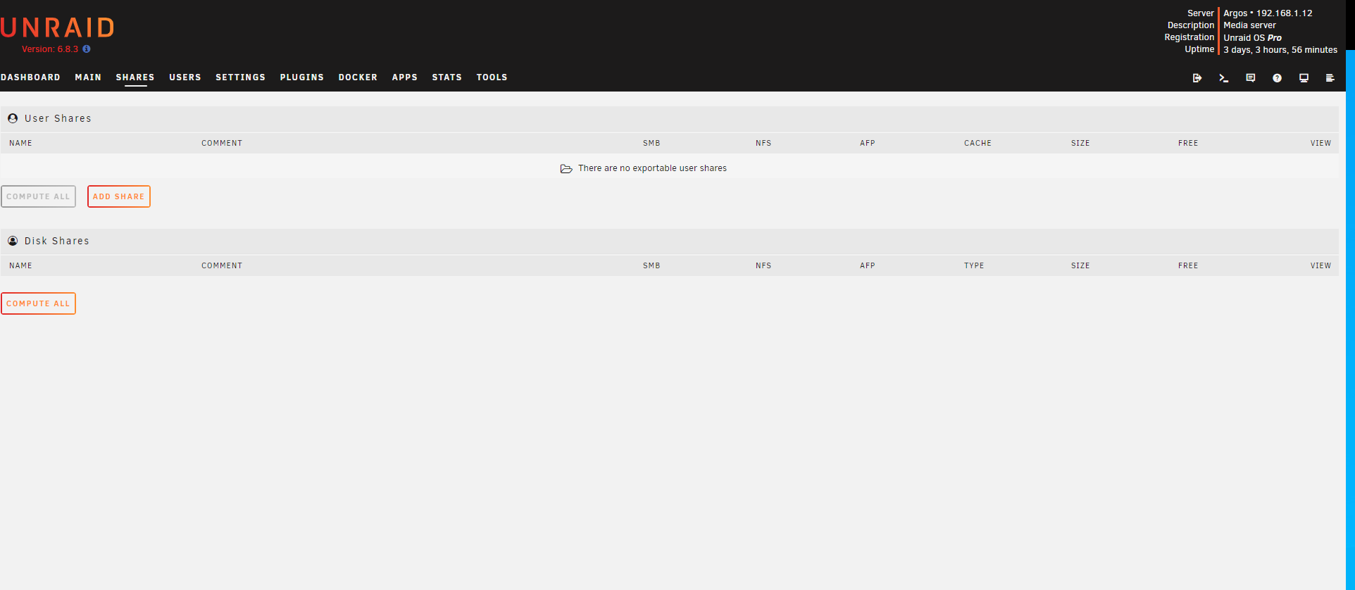

I am getting some interetsing errors after a day or 3 of running my shares drop and all my dockers cease to work, the gui of course is also buggy and not working. server has 72gb of ram and 49tb of free space....
The only way to fix it is by rebooting the server

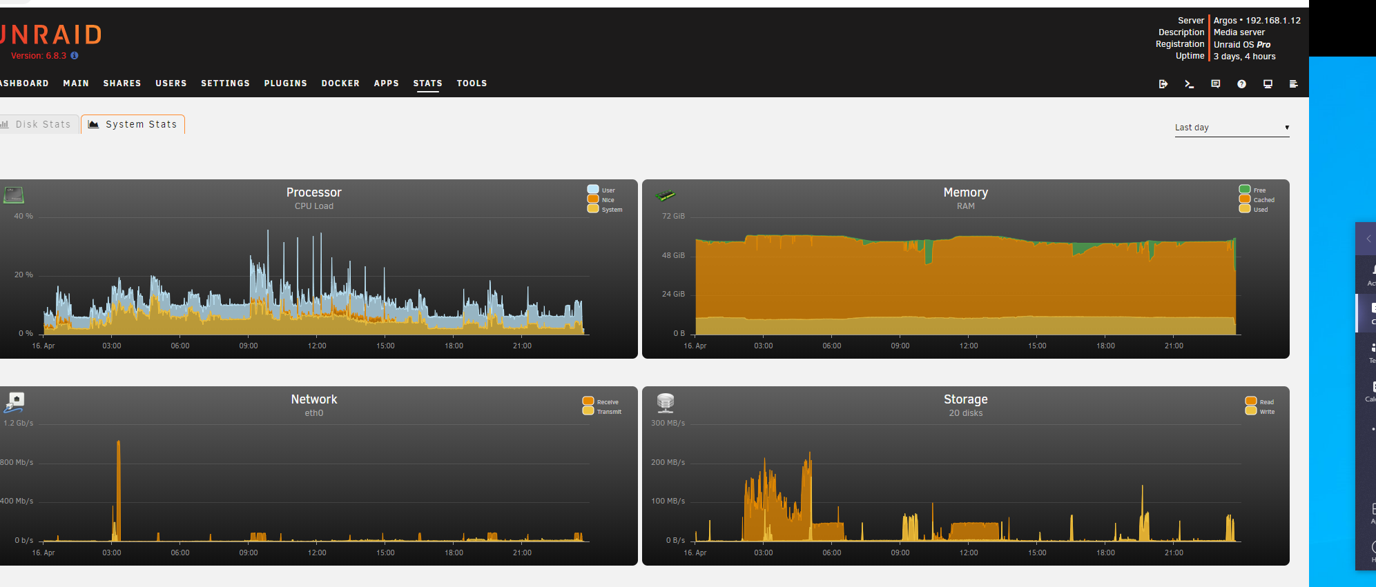

I am running crashplan as a docker which is trying to backup several tb of data could it be eating up all the memory ?

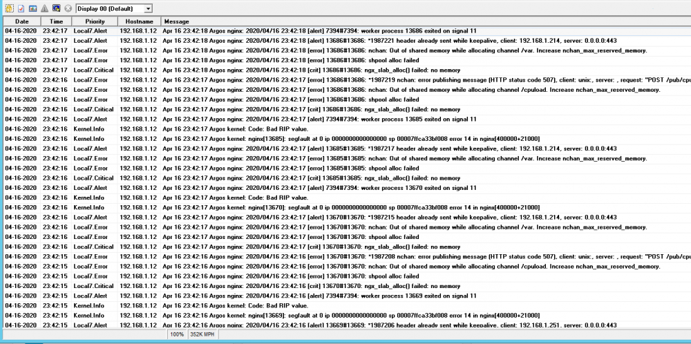

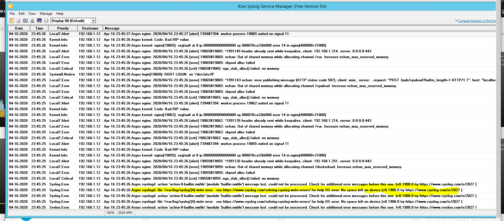

I am seeing this error in syslogs
2020-04-15 09:36:47    Local7.Alert    192.168.1.12    Apr 15 09:36:47 Argos nginx: 2020/04/15 09:36:47 [alert] 7394#7394: worker process 4099 exited on signal 6
2020-04-15 09:36:47    Local7.Critical    192.168.1.12    Apr 15 09:36:47 Argos nginx: 2020/04/15 09:36:47 [crit] 4100#4100: ngx_slab_alloc() failed: no memory
2020-04-15 09:36:47    Local7.Error    192.168.1.12    Apr 15 09:36:47 Argos nginx: 2020/04/15 09:36:47 [error] 4100#4100: shpool alloc failed
2020-04-15 09:36:47    Local7.Error    192.168.1.12    Apr 15 09:36:47 Argos nginx: 2020/04/15 09:36:47 [error] 4100#4100: nchan: Out of shared memory while allocating message of size 996. Increase nchan_max_reserved_memory.
2020-04-15 09:36:47    Local7.Error    192.168.1.12    Apr 15 09:36:47 Argos nginx: 2020/04/15 09:36:47 [error] 4100#4100: *1035724 nchan: error publishing message (HTTP status code 500), client: unix:, server: , request: "POST /pub/cpuload?buffer_length=1 HTTP/1.1", host: "localhost"
2020-04-15 09:36:47    Local7.Error    192.168.1.12    Apr 15 09:36:47 Argos nginx: 2020/04/15 09:36:47 [error] 4100#4100: MEMSTORE:00: can't create shared message for channel /cpuload
2020-04-15 09:36:48    Local7.Alert    192.168.1.12    Apr 15 09:36:48 Argos nginx: 2020/04/15 09:36:48 [alert] 7394#7394: worker process 4100 exited on signal 6
2020-04-15 09:36:48    Local7.Critical    192.168.1.12    Apr 15 09:36:48 Argos nginx: 2020/04/15 09:36:48 [crit] 4113#4113: ngx_slab_alloc() failed: no memory
2020-04-15 09:36:48    Local7.Error    192.168.1.12    Apr 15 09:36:48 Argos nginx: 2020/04/15 09:36:48 [error] 4113#4113: shpool alloc failed
2020-04-15 09:36:48    Local7.Error    192.168.1.12    Apr 15 09:36:48 Argos nginx: 2020/04/15 09:36:48 [error] 4113#4113: nchan: Out of shared memory while allocating message of size 995. Increase nchan_max_reserved_memory.
2020-04-15 09:36:48    Local7.Error    192.168.1.12    Apr 15 09:36:48 Argos nginx: 2020/04/15 09:36:48 [error] 4113#4113: *1035729 nchan: error publishing message (HTTP status code 500), client: unix:, server: , request: "POST /pub/cpuload?buffer_length=1 HTTP/1.1", host: "localhost"
2020-04-15 09:36:48    Local7.Error    192.168.1.12    Apr 15 09:36:48 Argos nginx: 2020/04/15 09:36:48 [error] 4113#4113: MEMSTORE:00: can't create shared message for channel /cpuload
2020-04-15 09:36:49    Local7.Alert    192.168.1.12    Apr 15 09:36:49 Argos nginx: 2020/04/15 09:36:49 [alert] 7394#7394: worker process 4113 exited on signal 6
2020-04-15 09:36:49    Local7.Alert    192.168.1.12    Apr 15 09:36:49 Argos nginx: 2020/04/15 09:36:49 [alert] 7394#7394: worker process 4114 exited on signal 6
2020-04-15 09:36:49    Local7.Critical    192.168.1.12    Apr 15 09:36:49 Argos nginx: 2020/04/15 09:36:49 [crit] 4115#4115: ngx_slab_alloc() failed: no memory
2020-04-15 09:36:49    Local7.Error    192.168.1.12    Apr 15 09:36:49 Argos nginx: 2020/04/15 09:36:49 [error] 4115#4115: shpool alloc failed
2020-04-15 09:36:49    Local7.Error    192.168.1.12    Apr 15 09:36:49 Argos nginx: 2020/04/15 09:36:49 [error] 4115#4115: nchan: Out of shared memory while allocating message of size 997. Increase nchan_max_reserved_memory.
2020-04-15 09:36:49    Local7.Error    192.168.1.12    Apr 15 09:36:49 Argos nginx: 2020/04/15 09:36:49 [error] 4115#4115: *1035752 nchan: error publishing message (HTTP status code 500), client: unix:, server: , request: "POST /pub/cpuload?buffer_length=1 HTTP/1.1", host: "localhost"

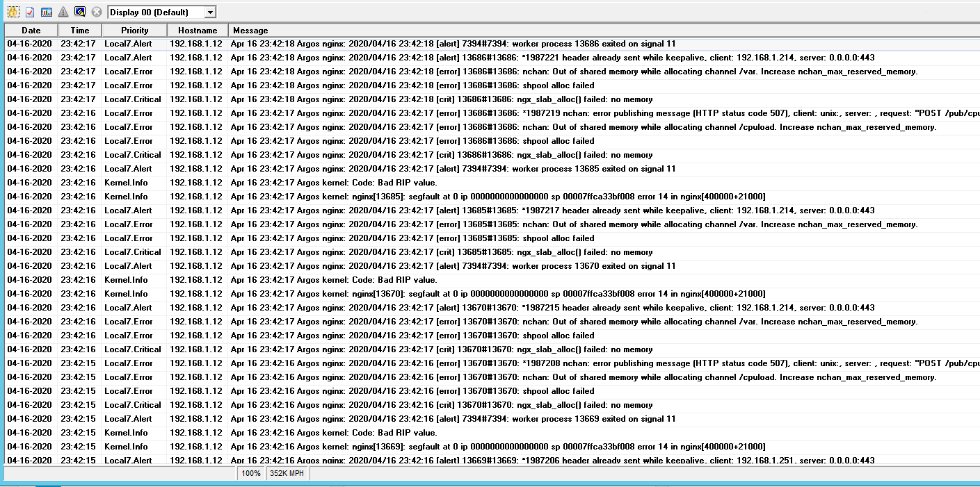

Also as an fyi i cannot run the normal diags on this as of course they are frozen when the server is... the logs after a reboot are here

Attached are the logs form my syslog server, sorry they are quite big
SyslogCatchAll-2020-04-16.zip
File is too big, even for Notepad ++, post the standard diags, so we can see if something is spamming the syslog.
