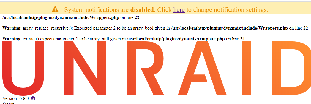

Hey Everyone... I was trying to add some new disks that were not formatting correctly so i added the "unassigned Devices" plugin and "binhex-preclear" to my box... something got horked and now my UI looks like gunk and this message is showing:
Warning: parse_ini_file(/boot/config/plugins/dynamix/dynamix.cfg): failed to open stream: Success in /usr/local/emhttp/plugins/dynamix/include/Wrappers.php on line 22 Warning: array_replace_recursive(): Expected parameter 2 to be an array, bool given in /usr/local/emhttp/plugins/dynamix/include/Wrappers.php on line 22 Warning: extract() expects parameter 1 to be array, null given in /usr/local/emhttp/plugins/dynamix/include/DeviceList.php on line 24
it got funky as soon as i added the binhex-preclear plugin so i stopped the plugin and removed it, but still no love. I uninstalled the dynamix plugin and rebooted, reinstalled the dynamix plugin, rebooted again, still getting the wierd messages.  Everything else is working fine though, all of the docker containers seem to function fine. Is there an easy way to just update UnRAID to get the system back to its "normal" state?

This empirically is due to the binhex-preclear install but only indirectly.  When you install that plugin it asks you for volume mounts to give to the underlying docker daemon for mounting inside the docker container.  Host Path 6 is /boot/config/plugins/dynamix/dynamix.cfg.  This *should* be a file, I'm assuming, but didn't exist on my unraid.  When you give docker a path that doesn't exist it will automatically create a folder given that path.  So when I installed binhex-preclear the docker daemon created the folder /boot/config/plugins/dynamix/dynamix.cfg/  If you make this folder and refresh your WebUI you will see that it generates php errors described above.
The *easiest* fix is:
1.  Uninstall the binhex-preclear plugin/app
2.  remove that path from your dynamix plugins folder (or at the very least move it to another name that *doesn't* end in .cfg)
     *  You can move the offending directory out of the way via the terminal with the command:
         * mv /boot/config/plugins/dynamix/dynamix.cfg /boot/config/plugins/dynamix/dynamix.cfg.broken
     *  Or if you want to remove it
         * rmdir /boot/config/plugins/dynamix/dynamix.cfg
3.  Now refresh the WebUI and you'll see the errors are gone.
Now if you want to reinstall the binhex-preclear plugin you should first create that file that the plugin wants to pass through to the docker container.  From the terminal run the command:
touch /boot/config/plugins/dynamix/dynamix.cfg
[EDIT] Squid pointed out that if you make changes within Settings -> Display Settings this will create the file /boot/config/plugins/dynamix/dynamix.cfg so there's no need to enter the terminal if you don't want to.
Then proceed with the install as you normally would and things should operate just fine.

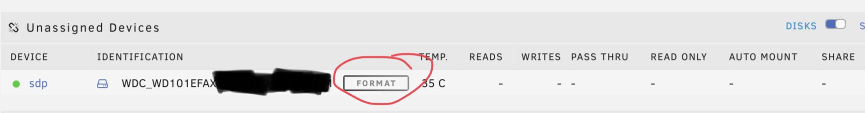

Just read thru last couple pages of this thread. Seems like everything is taken care of (known bugs anyway) but was looking for some confirmation before clearing a 10TB drive with this docker. Also, my parity is currently rebuilding and the new disk is unassigned and not formatted. I guess I need to wait to stop array and format or does the preclear script also do this per my disk setting (ie MBR 4K aligned)?
You must add a disk to Unraid BEFORE trying to format it as formatting a disk destroys its ‘Clear’ status.
Disk is “added” but unassigned. I want to preclear the disk so it’s ready in case of a drive failure. I just don’t remember seeing the format notice on a device before but I haven’t added or precleared a drive in quite some time!
So the order of operations is preclear, format, assign?
Edited by betaman
Added means ADDED to the array.
So no this is not correct. If you format the precleared disk before you assign it, then it won't be clear anymore and Unraid will have to clear it.
