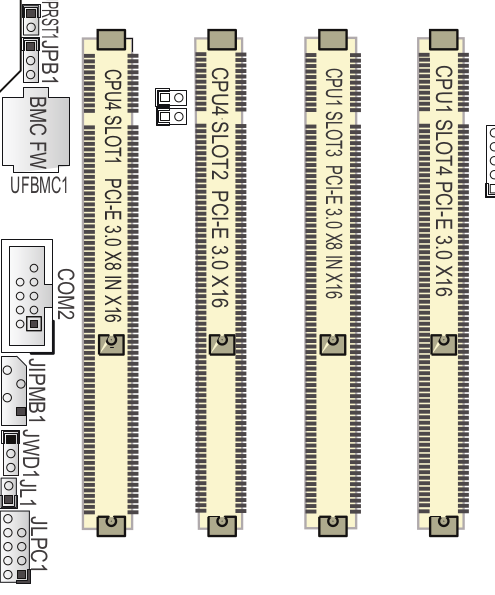

ok .. again thanks so much ... looks a little smaller ... i am sending a pic on the mother board and see if you all think that it is the same pci-e 3.0 x16 if you would please.
thanks john

It will work but it maybe tight next to another slot so you might lose a slot to use.
