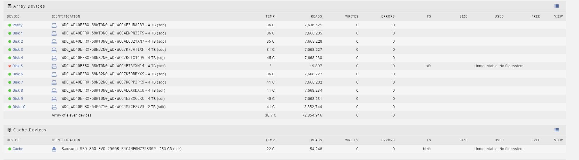

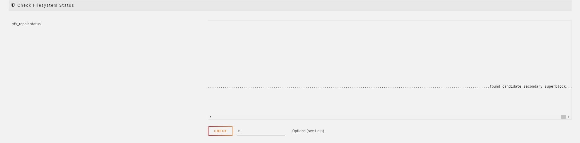

Yesterday I had a double "unmountable file system" error... One array drive and a cache drive.......

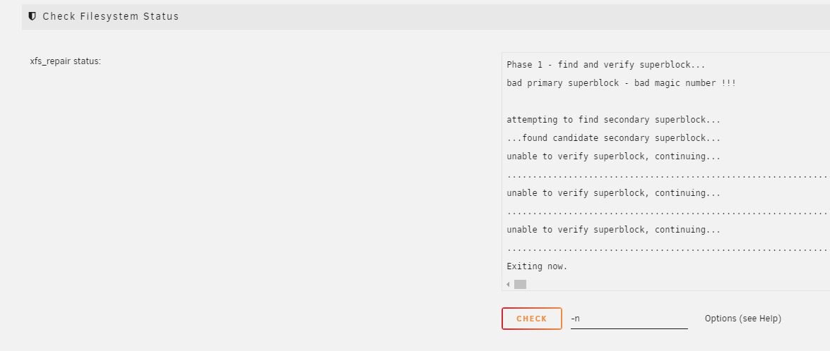

Concentrating on the array drive, after putting the array in maintenance mode, I checked the file system......
That image doesn't show that it took overnight to reach that stage. If I move that slider fully to the right, it displayed......

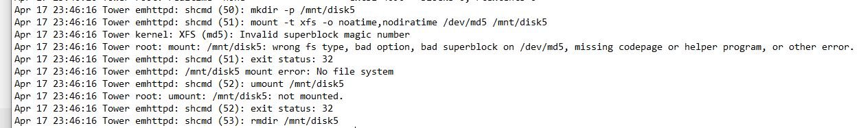

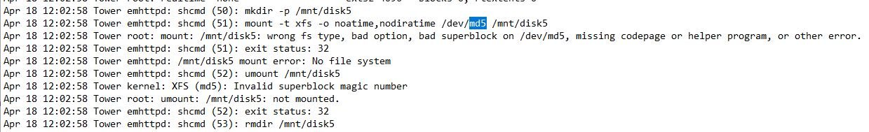

The syslog showed;
After a reboot it still shows;
Advice please as to my next move!

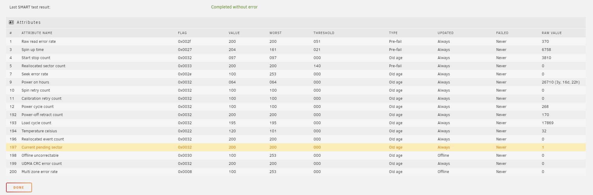

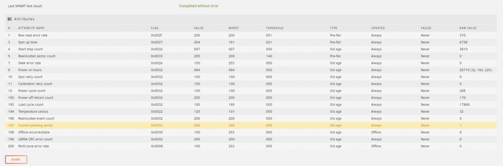

p.s; attached are before and after diagnostics.... and a smart report for disk5..

Superblock on the emulated disk is missing/corrupt, that suggest parity wasn't 100% valid.
You can see if the actual disk mounts with UD, though since the disk appears to be failing it might be good to clone it with ddrescue first.

15 minutes ago, pm1961 said:
The disk does mount as an UD...... Does that generate other options?
Yes, either copy everything you can from UD to the array (better after replacing the disable disk) or use ddrecue to clone it to a new disk then rebuild parity based on that, ddrescue is fairly simple to use, more info here.
17 minutes ago, pm1961 said:
Would a blunt solution be to replace the disk and rebuild or are you suggesting the parity might not be up to it?
If the emulated disk is unmountable (and not fixable) same will happen if you rebuild to a new disk.
