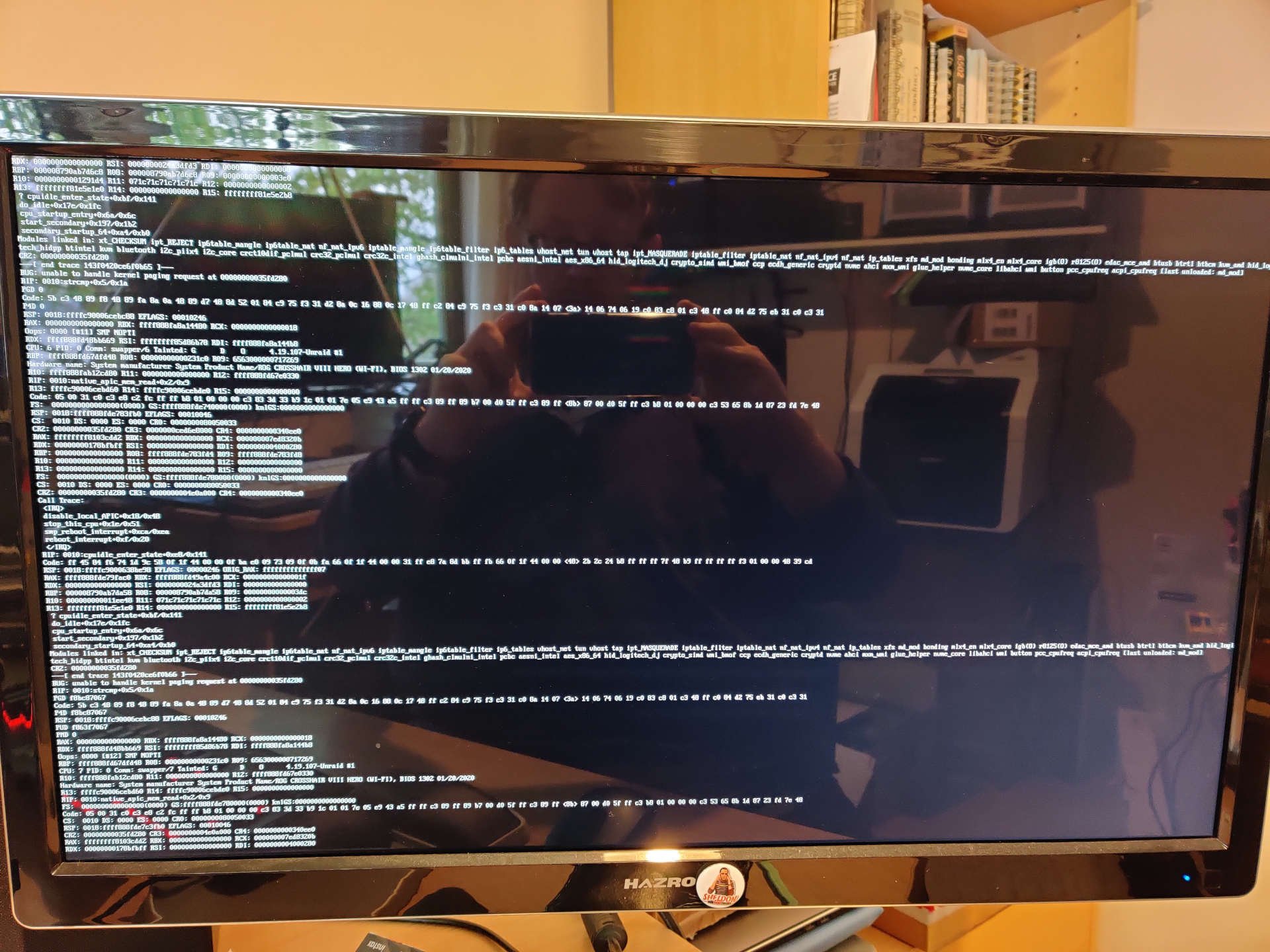

I started off by working my way through SpaceInvader One's tutorial on setting up a Windows VM without passthrough. This worked fine, and I was about to embark on GPU passthrough when unRAID paniced. I've attached a screenshot showing the panic strings from the console. When the system crashed, no VMs were running, and I was just clicking between the tabs in the WebUI.

Try running the ram at 3200 or below. I have a 2700x it seems like ram overclocks can make the system unstable. Remember anything over 2133 for ram is a overclock.
Problems seems be CPU_idle, pls try disable C6 or disable some APM ( advance power management ) option for troubleshooting.
Pls
- Run latest beta with 5.x kernel.
Edited by Benson
Having the same problem currently.
Do you by any chance have docker containers set up with an IP on the br0 interface? If so, switch them to host or bridge mode. This completely resolved the random crashes w/ Ryzen on my end. Make sure there is nothing on the br0 interface.
