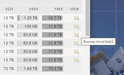

4.) Opened the Unraid Main Tab and viewed the content of Disk3. Everything looked good:

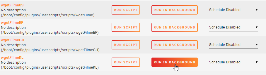

5.) Installed the CA user scripts plugin. Added a new script with the following content (direct execution by terminal would be possible, too) to fetch the files from the source NAS through FTP (this script is helpful to backup websites as well):
wget --background --quiet --recursive --level 0 --no-host-directories --cut-dirs=2 --no-verbose --timestamping --backups=0 --user=<ftp_username> --password=<ftp_password> "ftp://10.1.2.3/video/Filme/GH/" --directory-prefix=/mnt/user/Movies
6.) Added this script multiple times for multiple copy processes on different disks and different folder names (in my case the letters). Then I clicked on "Run in Background" and now I need to wait...

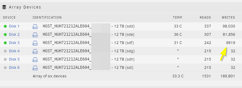

In the main tab the "Writes" column rises on the corresponding disks, so everything looks good:

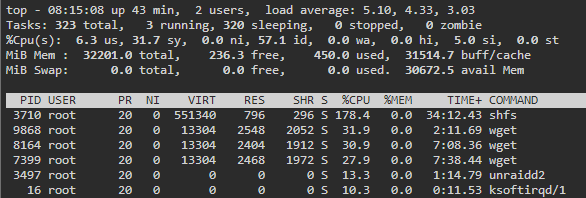

7.) Finally I opened the terminal again and typed in "top" to check if there are still active wget process:

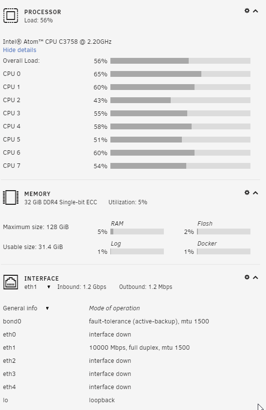

So it works now, but I hoped it would copy faster. The maximum is 970 Mbps altough 10G network is used and a parity disk is not set up:

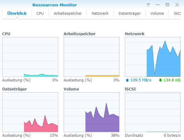

10G source:
 The load looks good as well:

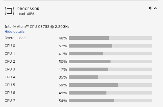

Source:
EDIT: Started a fourth wget process (now copying to four disks at the same time) and now I reach 1.2 Gbps:
This means around 30 MB/s per disk. Much lower than the disks maximum write speed?!
Not a good idea to write to multiple array disks at the same time since parity needs to updated for all and it will bottleneck.
