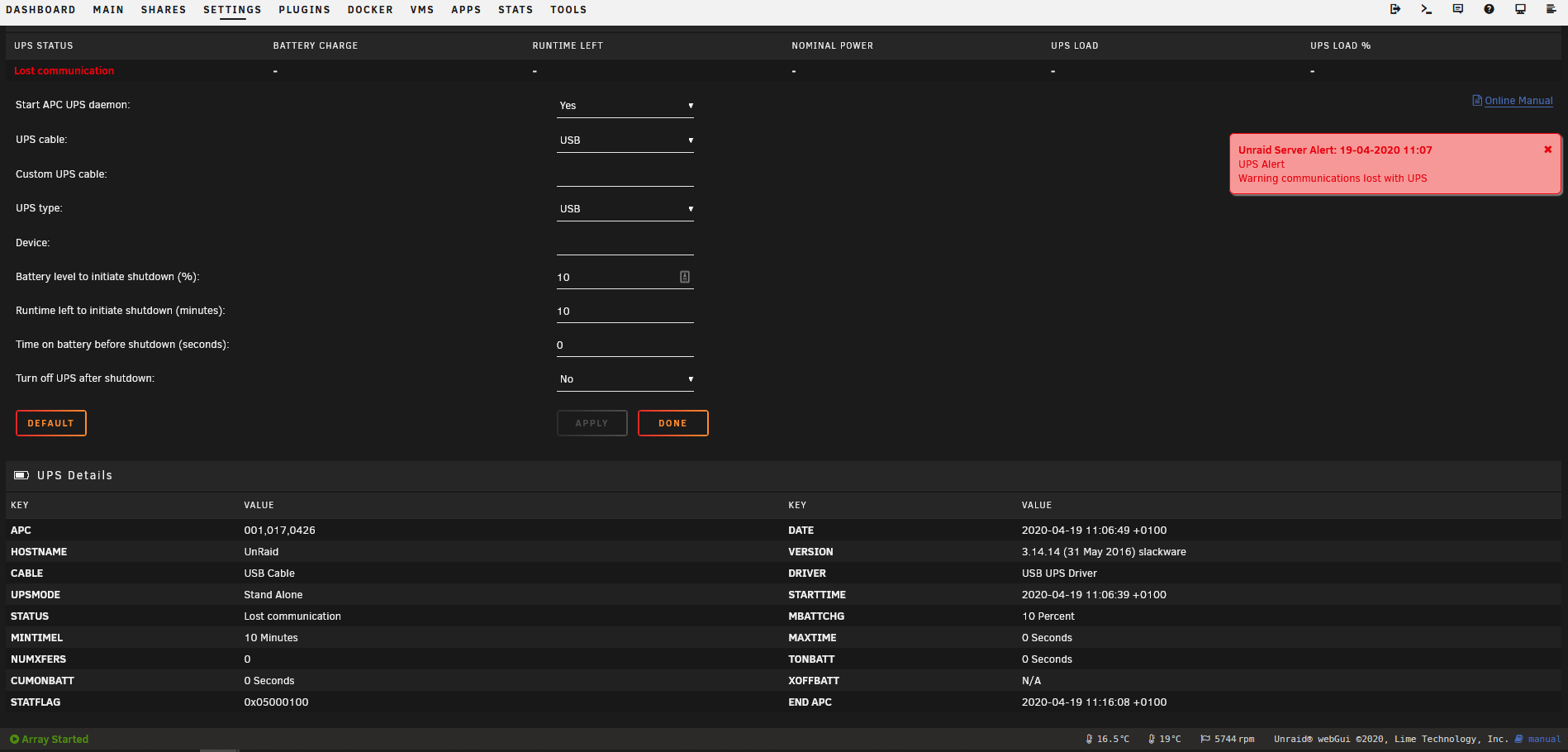

Hi guys,
After many years I eventually went and bought a UPS device and after reading a number of forums here I eventually went with APC 1200gi, (Reconditioned) more than what I need and according to the forums here it will work with Unraid. However I cannot seem to get it to communicate with my setup. I had to get a separate cable, USB to Ethernet (maybe I have the wrong cable) and have tried various combinations of Cable type and UPS type in the ups settings page as well as various USB ports on the motherboard  but same no communications warning. Attached a screenshot of the UPS settings page.
Anyway thanks in advance for any help ye can offer
Where you got the cable ? Any info. or link.
1 hour ago, demon1 said:
This cable is USB to 232, not for APC UPS.
You should buy something like as below
https://www.ebay.com/c/1331429843
Edited by Benson
Thanks Benson, cable ordered now.
