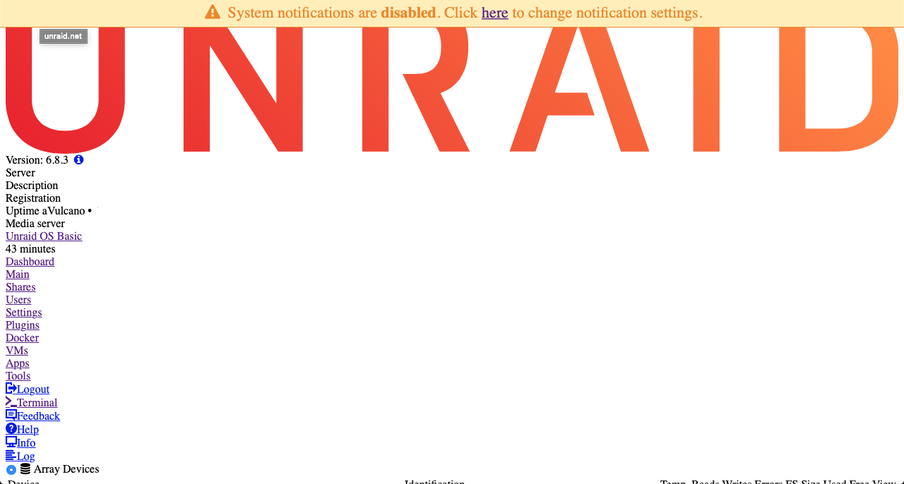

Hello, so all of a sudden my web ui looks like this on my windows laptop, google chrome,image.thumb.png.7234cce3ce2974e00532aeee560715d3.png
but then on my phone it looks fine, any reason as to why this is.
Presume it someting very simple, version number is 6.8.2

i have the same problem, I just installed a plugIN and I think that broke it. is there a way to remove the last 2 plugIN's? or can I reinstall UNRAID over a existing installation and cut that fix that? (it is also in other Browser on other Computer)
If you delete the .plg file from config/plugins on flash the plugin won't be reinstalled at boot. But there may be more likely causes for your problem. Did you try the suggestions in the post just above yours?

it look's like that... 😞

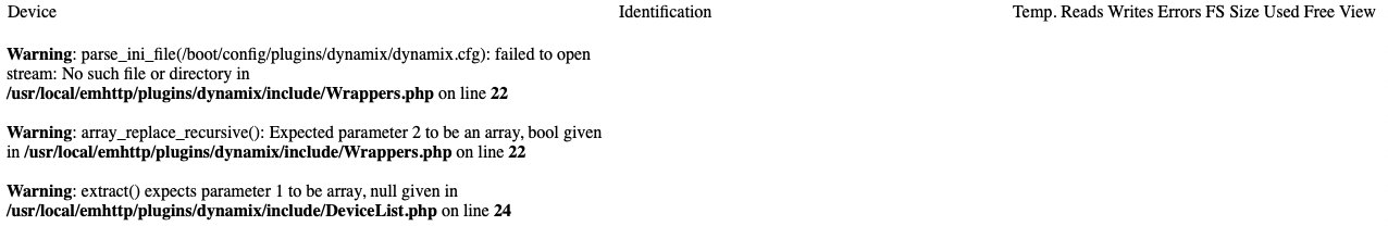

it looks like in the log:
Apr 30 16:05:22 mYserver nginx: 2020/04/30 16:05:22 [error]

(tried) uninstalled them and reinstalled the os (update) to 6.9 and back to 6.8.3 still looks the same... 😞
711082855_Bildschirmfoto2020-04-30um18_25_36.thumb.png.c279ceca7a8b3a97e852bf147203bffc.png591282057_Bildschirmfoto2020-04-30um18_23_07.thumb.png.9a4aebcdc112d8ca2686a9ff6327b3b5.png
1619611615_Bildschirmfoto2020-04-30um16_45_36.thumb.png.1b7c042183d3a68cd0b9ba2a91e3aed7.png

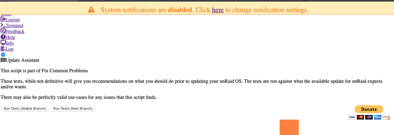

Was the banner about system notifications being disabled there before the UI went nuts?  If not, it's because your flash drive decided to drop offline / have issues

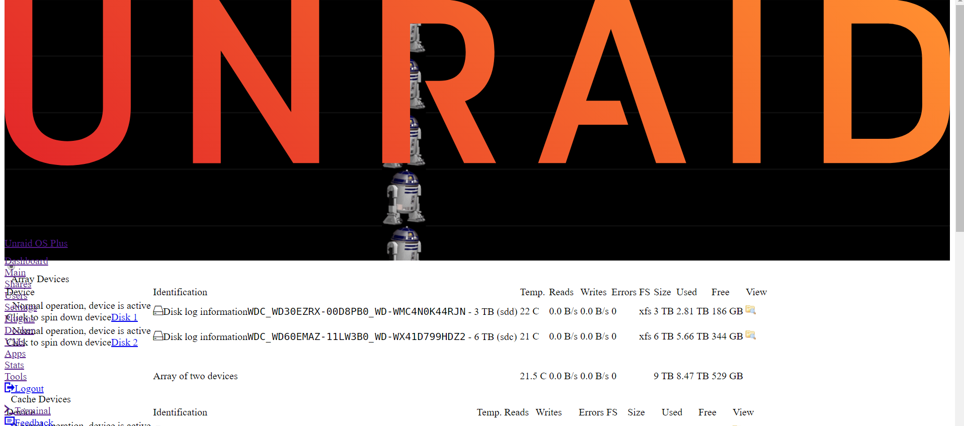

yes and also a new computer and 2 other Mac's the same... ;-(

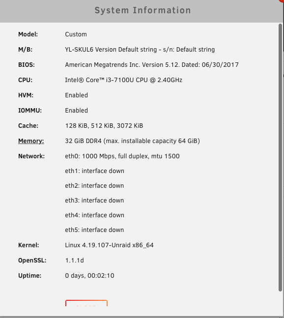

it is also in other Browser yes Chrome on mac / safari on two other mac's and FireFox and iE11 or so and Opera on mac an pc (most of them have no connection to each other (account or so) no have ever connected to the UnRaid....(that i have running on a new Samsung 64gb USB 3.0 Stick)  One Samsung 500GB SSD EVO Sata and one Seagate FireCuda 2TB
616572942_Bildschirmfoto2020-04-30um00_16_27.png.b788ea426896e868a9ecd2300f5a7252.png
Flash drive problem is another likely cause of webUI issues. Make sure you are booting from a USB2 port.
