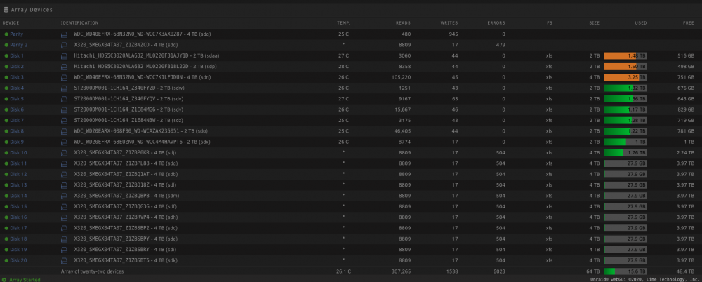

Well.. it didn't take that long, but I'm getting the following errors now:
Unraid array errors: 2020-05-03 04:42
Warning [TOWER] - array has errors
Array has 12 disks with read errors
Here's my diagnostics file (without a reboot)
tower-diagnostics-20200504-0925.zip
Disks 10-20 plus parity2 all disconnected. Are these on the same controller?
Looks like a problem with the enclosure, there was a reset and lost communication with all disks:
May  3 04:41:15 Tower kernel: scsi 3:0:13:0: Enclosure         NETAPP   DS424IOM3        0212 PQ: 0 ANSI: 5
May  3 04:41:15 Tower kernel: scsi 3:0:13:0: Power-on or device reset occurred
Yes, they're all on the same controller.
but all the disk are still showing online on my dashboard.
1482599298_ScreenShot2020-05-04at10_21_10AM.thumb.png.0d9e45a7844ed0f64e750ec5db6f3f1f.png
