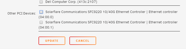

When i edit the VM settings ( ubuntu ) i can see two devices listed:

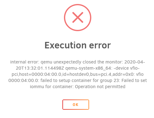

However, when i assign (1 or both) of them to the VM. I get the following error on startup:
I've included the diagnotics file below:
dl360-20core-diagnostics-20200420-2128.zip
I have a feeling this card is doing something weird and may not be supported, but i wanted to check if any experts could help before i move it into a dedicated machine.

your log shows
vfio-pci 0000:04:00.0: Device is ineligible for IOMMU domain attach due to platform RMRR requirement.
you need

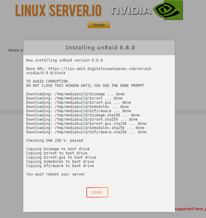

install this:
then once installed (and possibly rebooting) go to settings>Unraid Nvidia. once there, look for the stock Unraid builds, pick one, let it install, reboot. then you'll need to go back to the github site for the right patch that aligns with the Unraid version you picked, copy that bzimage to the flash drive, reboot, and then report.
2 hours ago, 1812 said:
noooo, don't format the drive.
install this:
Thank You! - really useful tool.
I Installed the plugin from https://raw.githubusercontent.com/linuxserver/Unraid-Nvidia-Plugin/master/plugins/Unraid-Nvidia.plg - Then rolled back to 6.8.0
Rebooted the server, everything seems to be working.

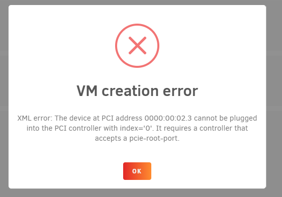

Strange i have a different error now:
I moved on, i copied over https://github.com/AnnabellaRenee87/Unraid-HP-Proliant-Edition/blob/master/bzimage releases/Stable/6-8-0/bzimage to the flash drive, rebooted and everything started fine.
Got the same error as above.
dl360-20core-diagnostics-20200428-1026.zip
The logs do not mention anything relating to ineligible devices - perhaps the check did not happen in 6.8.0
I will research the error above
Thanks
Edited by happythatsme
I created a new VM - As i thought the XML from 6.8.3 may not be compatible with 6.8.0
I passed the card to the new VM and it booting right now... I will report back
