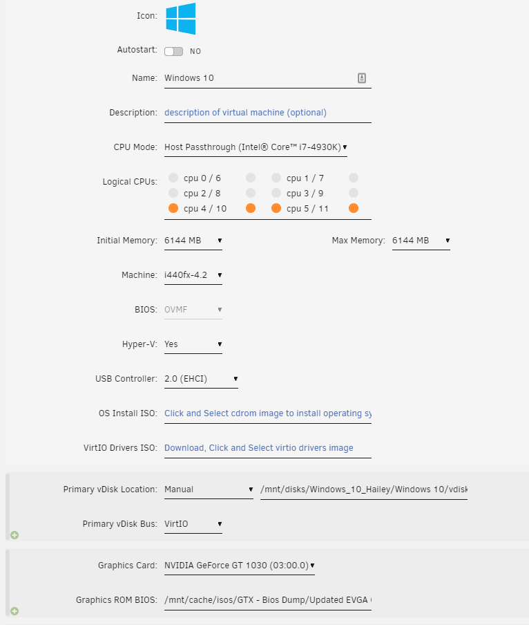

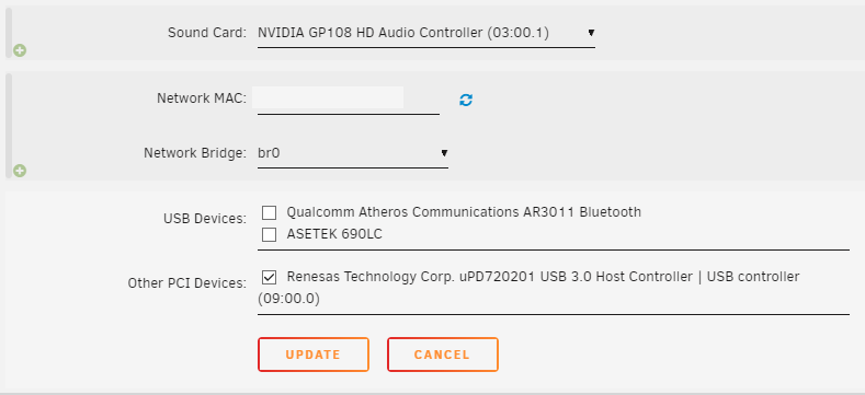

Right after starting a VM (game oriented VM with GPU passthro) One of my cores goes to 100% usage. It stays like that even if I shutdown the VM. Sometimes starting the VM is fine, but then upon shutting it down, it causes the whole UNRAID server to crash.
I notice I can temporarily "fix" the issue, of one or more of the cores going to 100%, by going to Shares and editing ANY share at all. Even if is just the Share's comment section. Basically, as long as I can hit 'Apply' when editing a share it 'resolves' the issue and the CPU core(s) goes back to normal. Sometimes, more cores do this and eventually leading to unraid crashing and needing a forceful shutdown. All dockers were turned off. VM works fine by the way. This doesn't appear to be the case with the second VM that doesn't have a pass-throu GPU.
It may be connected to something that gets 'restarted/cleared' upon editing one of the shares. I've looked around and the cases I've found were not resolved.
unraid5.png.0ea492600635e0e25de4ad63f959b9d5.pngunraid4.thumb.png.dfde6e7f119d86a38ae153ab83020cb0.pngunraid6.thumb.png.8976fab541c5c263628cc48bdc39bf91.png
This is my current diagnostics after the removal of the USB PCIE card, and a sound card I wasn't using. Currently, one of the cores is stuck at 100%. This happened after I started the VM. I shut it down, and it is still at 100%.

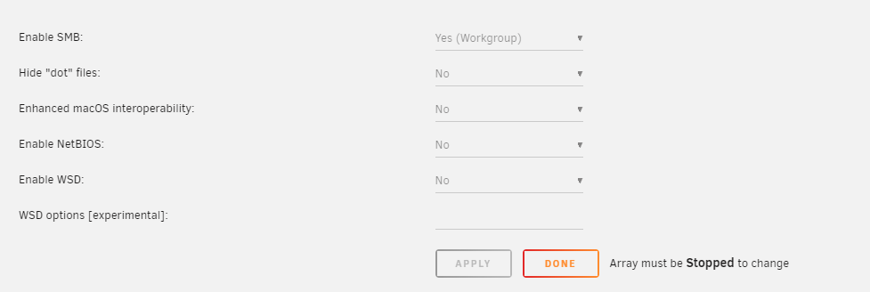

The core(s) going 100% appear to be caused by WSD. So I've disabled it to have fixed this issue. Before you ask, yes the server still appears under my network in Windows....after you've browsed to it directly, and it will disappear once you close the File Explorer. But who cares, you can still access it, or if you have it mapped it still there, still works, just not discovered automatically. Yes, its not great as we just got this feature recently (because it wasn't quiet working before on previous unraid versions unless you enabled SMB1 or something).
Settings -> SMB
