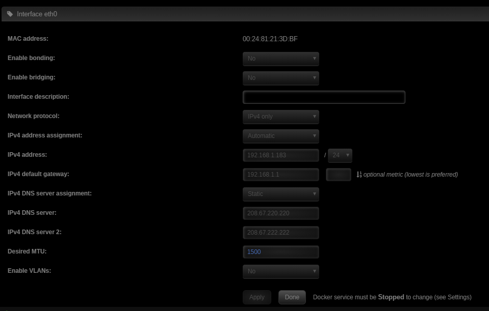

2 minutes ago, dsimmond1225 said:
network error message
What exact error message?  Try setting static DNS addresses of 208.67.220.220 and 208.67.222.222 in Settings - Network.

Can you ping google.com from the command line on your server?
still unable to ping google.com
unknown host
