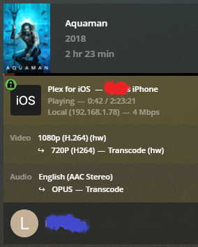

When transcoding, do you see the (hw) indicators in the Video section in Plex like this example?  My CPU usage when a hw transcoding is happening is less than 5%
