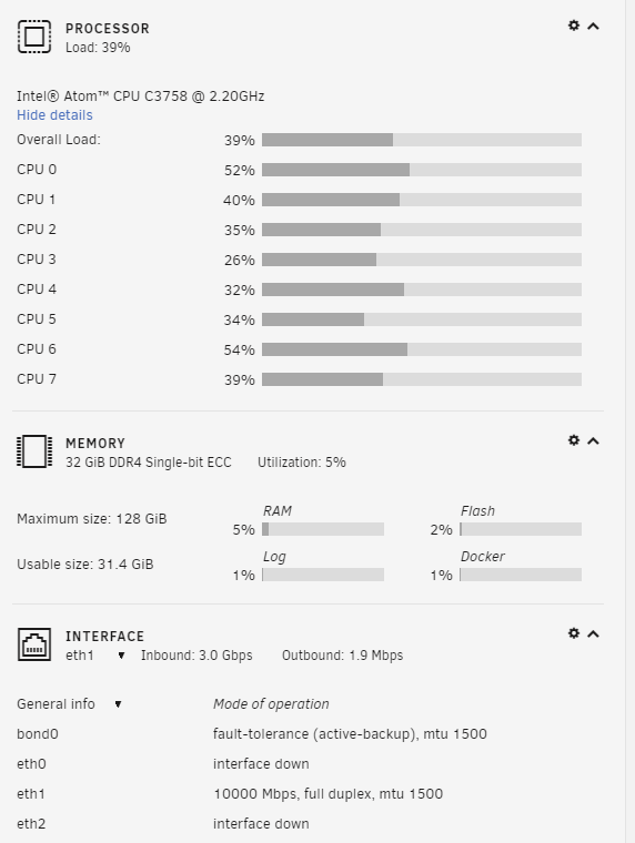

The Unraid server has 10G:

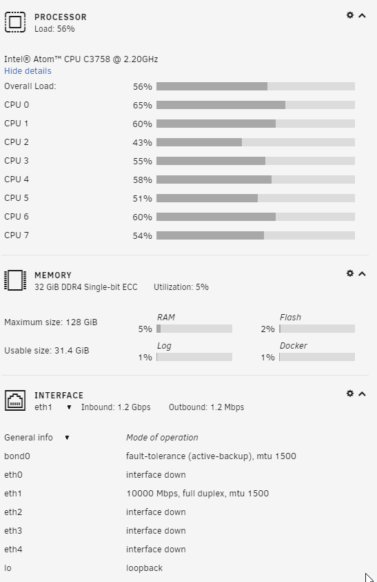

The source, too:
1456381396_2020-04-2117_30_44.png.db87e7ef58cde90a8af7c34cc9d5deaa.png.c1d37d447844c4a93f0e6d679f91b181.png

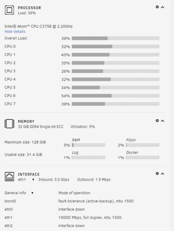

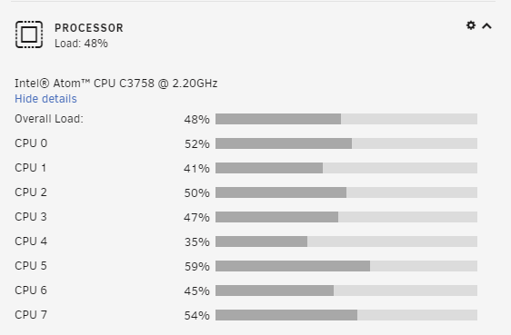

The load on the Unraid server looks good:
984344718_2020-04-2117_09_10.png.a80191cb47cd0d325a42ee979d860b21.png.9ebc850a3cc301ab9c8cf1c6cd8de04f.png
And on the source, too:
1302972632_2020-04-2117_34_22.png.d6265ba9335cd466e2e68854391aa1d7.png.a3c8c9cd6e0b34b158d1be0c0df0c69b.png

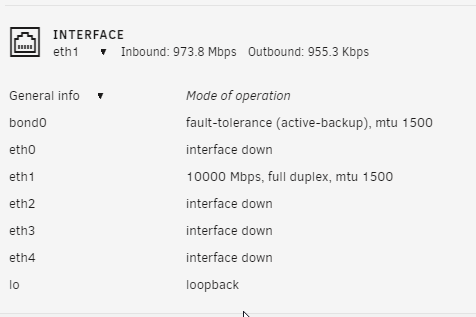

Finally I started a fourth wget process that targets disk 4. This wast the first time the transfer exceeded 1G:
1507769108_2020-04-2117_43_19.png.0ce2de9c7c26bed9cc3ba58a2901df20.thumb.png.abe04a2c8686025b780243bc2f61ce8f.png
Any idea why it could be so slow? I thought without parity it reaches the maximum write speed of the disk (up to 260 MB/s)?!

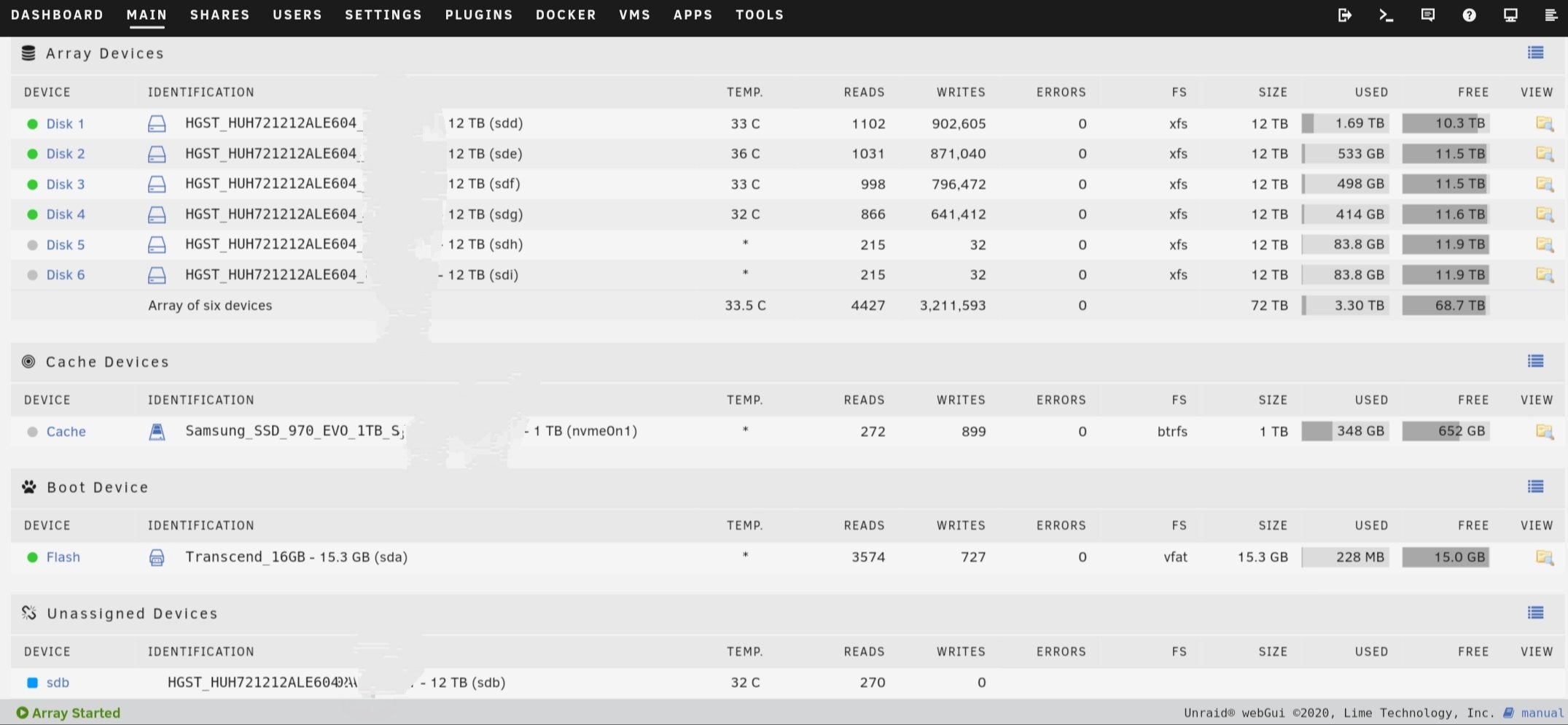

What does it say on the Main page?
P.S. it transfers mainly huge files (~25GB per file).

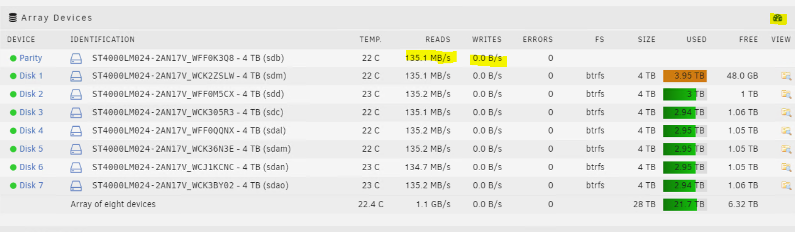

Also you can see real-time read/write speeds on the GUI, toggle is on the right upper corner:
Nice to know.
It jumps like crazy between 0 and 80 MB/s per Disk. Looks like wget is working in chunks.

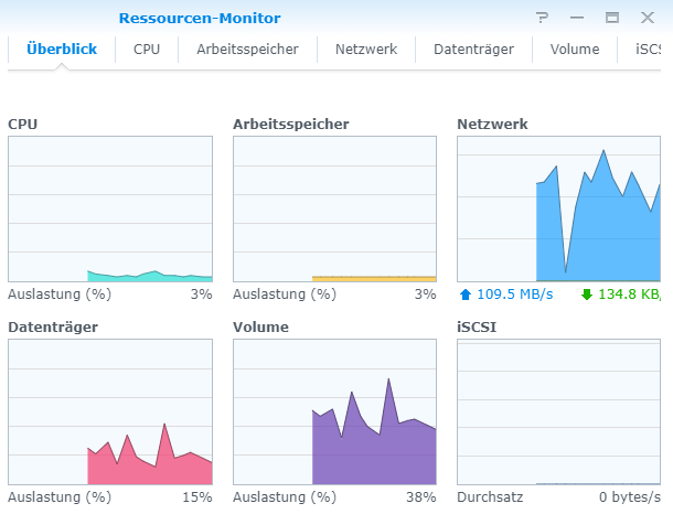

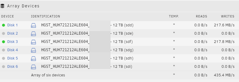

Yes it was caused by wget. I tried the following smbclient command (source) and it hits the max write speed of the disk:
smbclient //10.1.2.3/video <smb_password> -U <smb_user> -c 'prompt ON; recurse ON; cd \Filme\KL\; lcd /mnt/user/Movies/KL/;mget *'
I started two processes and its really fast now:
Funnily the load is not really different:

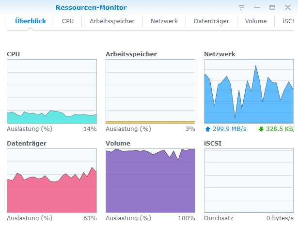

Sadly the source NAS seems to hit its limit now:
At least, I think that, because I was not able to raise the network traffic by starting three parallel smbclient processes, so I think the "volume utilization" is the bottleneck, now. I never really found out what Synology meant with that.
