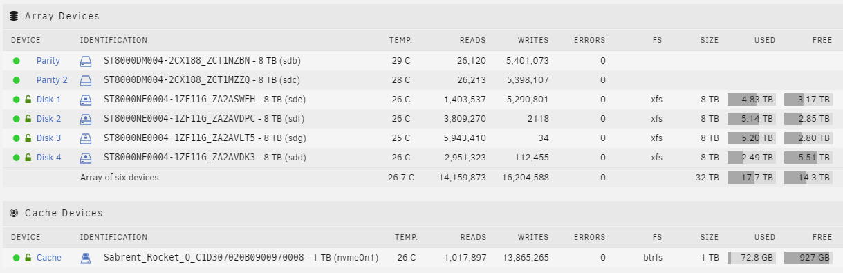

Newer to unRaid and NAS tech in general. After getting my array finally setup the way I wanted, I came across the sticky thread on SMR drives. I have since realized that it is possible that every drive I've had issues with in the last 6 years have been SMR or TGMR drives, perhaps because I've been using them like regular drives. Now understanding the purpose and technology behind SMR, I think I should rearrange my array. Here is a copy of my array stats from the last 11 days of uptime. This is representative of normal weekly usage. I'm constantly writing to Disk 1 data drive (backups/data/small and big files), and reading from the rest (mostly media/large files).
The two parity drives are Seagate Compute SMR drives. The 4 data drives are Ironwolf Pro CMR drives. After reviewing this usage, it seems the best decision would be to swap Disks 2 and 3 with the parity drives. If I understand everything correctly, I'll get better performance and longevity by using the CMR drives as parity, and the more economical SMR drives will perform well as mostly read drives in Disk 2 and 3.

I have offline backups of all critical data. I ended up with those Compute drives from another purpose, as I was building this server out, so I just added them to the array. Otherwise it would of only been 4 Ironwolf Pros and single parity. Typing this response is reminding me why I had setup the Compute drives in parity in the first place. The Ironwolf Pros have data recovery included. In the case of catastrophic failure of everything, I'd rather have Seagate working on recovering a drive that has data on it, and not parity bits. On the other hand, every drive that I have that has read errors is a SMR type drive. So, do I want my SMR parity drives to underperform and fail faster because of the writes, to potentially save the ability for Seagate to recover data from a failed drive, that is already backed up by parity and offline? This turned into me thinking out loud through the forum. I think I'm going to perform the change as scheduled, and move the Ironwolves to parity, since I'm rarely going to be writing large files to the SMR disks, so they should last a while under those conditions.
