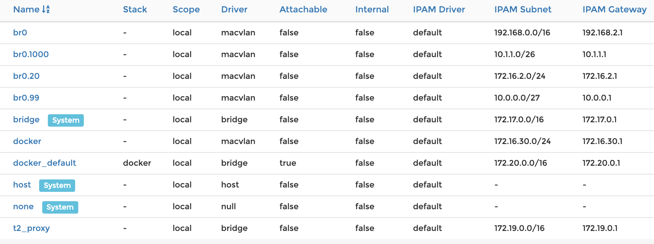

What interface is the problem container connected to? Also what interface is the Traefik container connected to?
The problem container is traefik, which is connected to t2_proxy network with all the other containers, except for unifi. The unifi container needs to be on the main network br0. From what I can tell from the logs, traefik is trying to route requests to my unifi container but there are no routes.

Have you tried connecting traefik to both the br0 and t2_proxy networks?

yes and traefik chokes and doesnt start back up. I have to disconnect the network from traefik for it work again. I maybe remove all these network i dont use anymore since i moved everything into docker.
Ideally i would have 192.168.0.0/16 and then the docker networks and that would be it.

this is weird. i access the containers shell and ping a few ip's on br0 and they come back just fine. go to ping the ip configured for the unifi container and all packets are lost. no matter if i change the ip to different ip or not.
