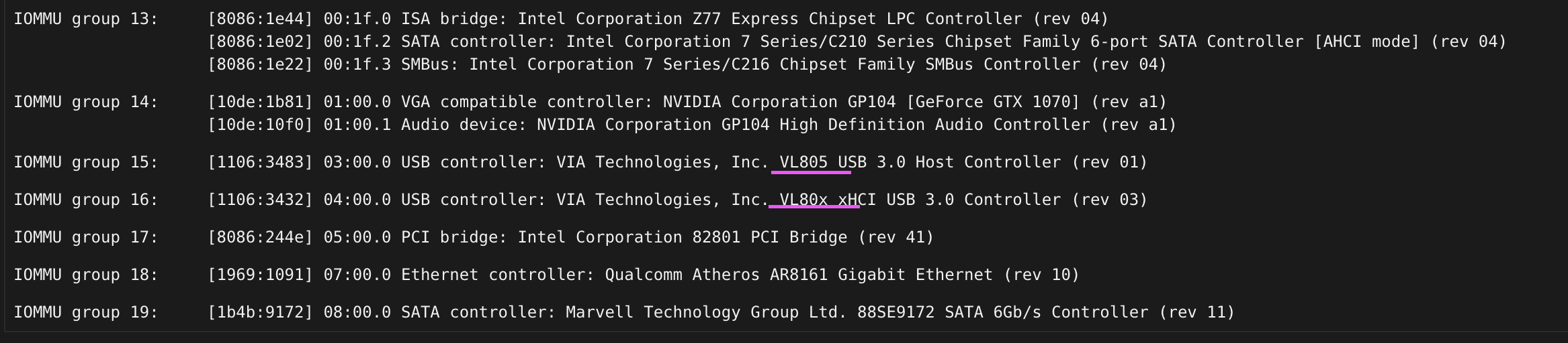

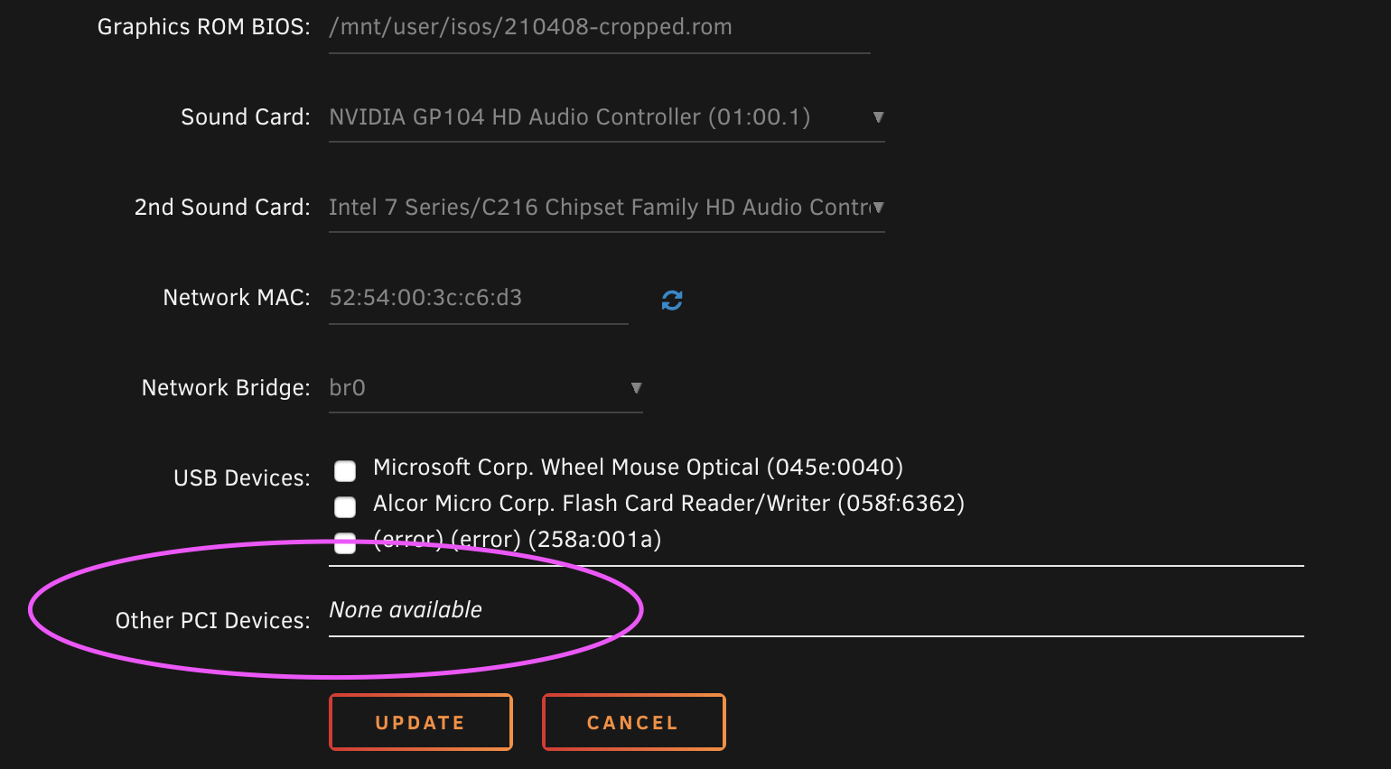

  1. The PCI usb card no longer appears in the VM screen to assign to a VM (see attached for VM edit screen, can't see it when creating new VM's either.)
    Strange thing is that the card does appear fine under tools > system devices817718037_ScreenShot2020-04-23at8_08_08am.thumb.png.a278c69c906f7cffe4fbdab4e7b2f899.png

  2. Now the mouse is appearing in my "USB devices" section whether it's actually not plugged in or not (which it is not). That section also has an "error"? That does not clear.
