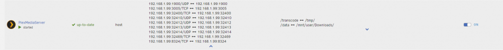

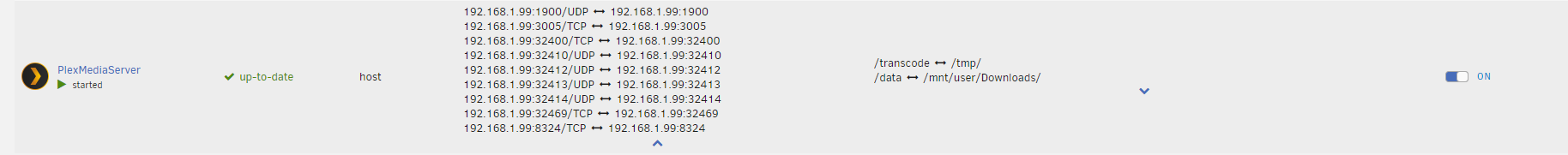

I did notice that there are a bunch of ports, not sure if those were there before:

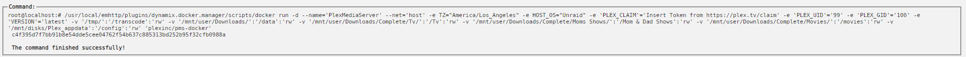

here's the run command:
If thats a little hard to read:
root@localhost:# /usr/local/emhttp/plugins/dynamix.docker.manager/scripts/docker run -d --name='PlexMediaServer' --net='host' -e TZ="America/Los_Angeles" -e HOST_OS="Unraid" -e 'PLEX_CLAIM'='Insert Token from https://plex.tv/claim' -e 'PLEX_UID'='99' -e 'PLEX_GID'='100' -e 'VERSION'='latest' -v '/tmp/':'/transcode':'rw' -v '/mnt/user/Downloads/':'/data':'rw' -v '/mnt/user/Downloads/Complete/Tv/':'/Tv':'rw' -v '/mnt/user/Downloads/Complete/Moms Shows/':'/Mom & Dad Shows':'rw' -v '/mnt/user/Downloads/Complete/Movies/':'/movies':'rw' -v '/mnt/disks/Plex_appdata':'/config':'rw' 'plexinc/pms-docker'
c4f395d7f7bb91b8e54dde5cee04762f54b637c885313bd252b95f32cfb0988a
