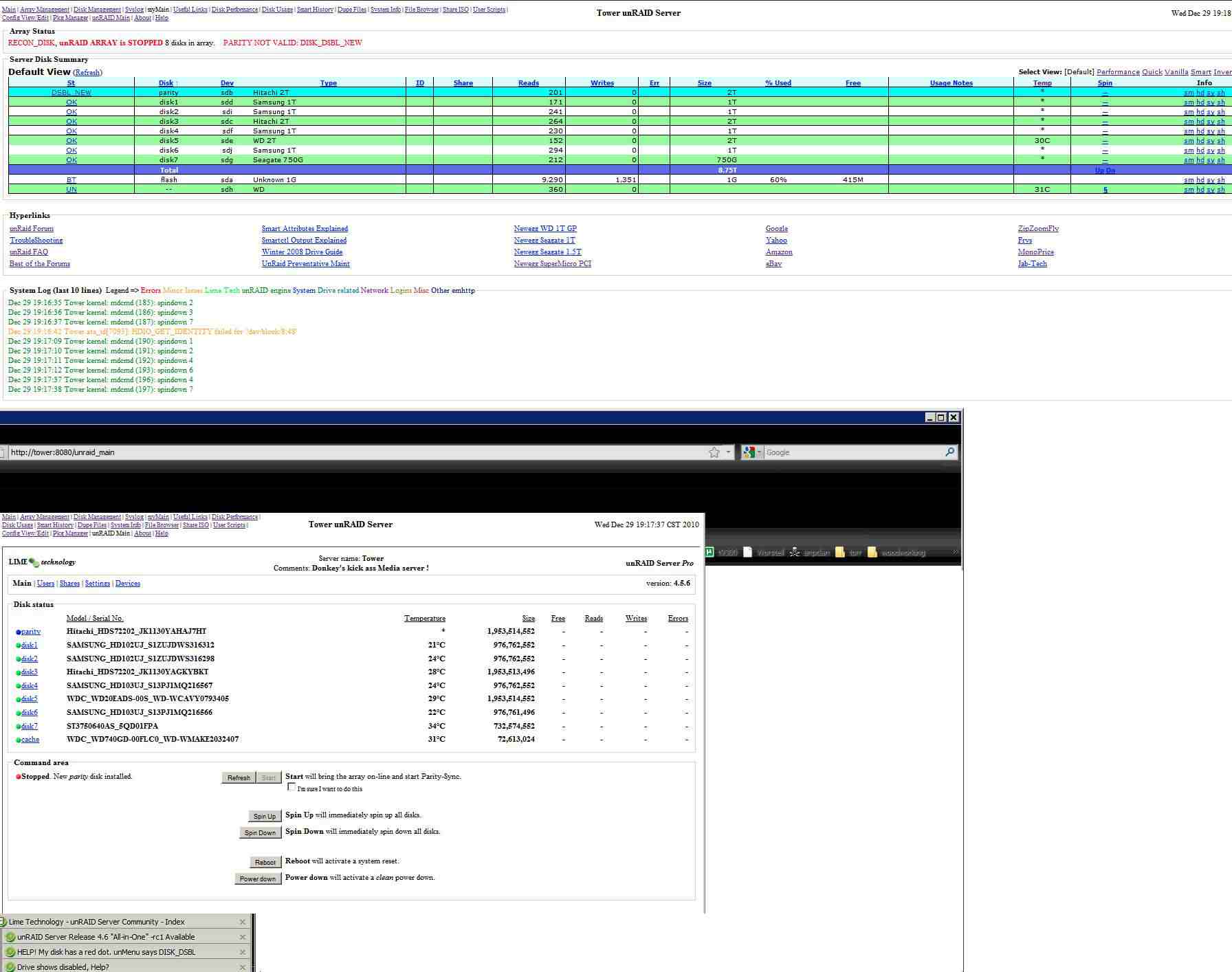

?I haven't made any changes to this server in weeks, but had trouble accessing certain files on it today.  After which, i then tried to access the web page, but couldn't.  Since it is run headless, I had originally added a script (from these forums) to run the shutdown script when the power btn is pushed once.  SO I pressed power,  and it appeared to access the flash drive for a while, and shut down gracefully.
When I booted unraid back up, i saw the following webpages with DSBL_NEW, and a Blue Ball near the parity drive. Again, i have NOT changed any hardware.
The zip file shows pre-shutdown and post-reboot syslogs.  One was 134MB over 12 hours, both syslogs are showing some drive errors.
My first instinct was to just hit "rebuild parity", but wasn't sure if this was the safest route. Is the parity drive still good?

[/img]C:\Users\d\Pictures\unraid_dsbl_docs\unraid drive blue ball disabled.jpg[/img]

Update...I tried to do a NOCORRECT parity check, but it just fails since array isn't started.  IS there a way to see if the parity drive has really failed?  I feel like if i just force it to recalc parity, i'm trusting all the other drives to be right, when i still cant understand why unraid thinks the parity drive is new  ???
latest syslog attached showing my attempt with unknown errors repeating above it,

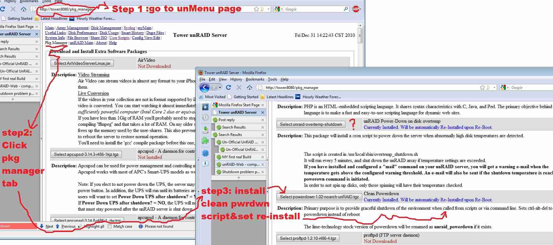

This would be very handy to have....could you please point me in the right direction?
The reason i was a bit vague about which script did it, is that i don't exactly remember, b/c I installed a lot of things all at once, after I discovered the Package Manager tab in the latest unMenu.  I believe the "clean powerdown" button on the screenshot below replaces the stock unraid pwrdn script with a less violent shutdown that won't induce a parity check every time.
I have the BIOS power button action set to "pwr off after 4 secs"...which means the that you have to press the power button coninuously for 4 secs to do a hard shutdown.  I beileve just pressing it once invokes the above script, perhaps by sending a CTRL-ALT-DEL, which is wha tthe script is designed to catch.
