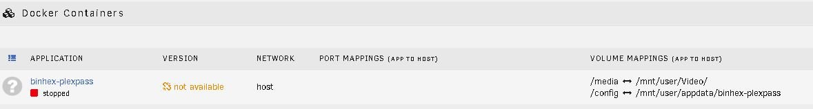

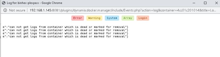

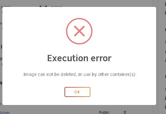

Hi Guys not sure if this is a Docker issue or a Unraid issue however i went to update my Binhex plexpass docker and it failed to update. now all i get is this? any ideas? If i try and start it i get the Execution error

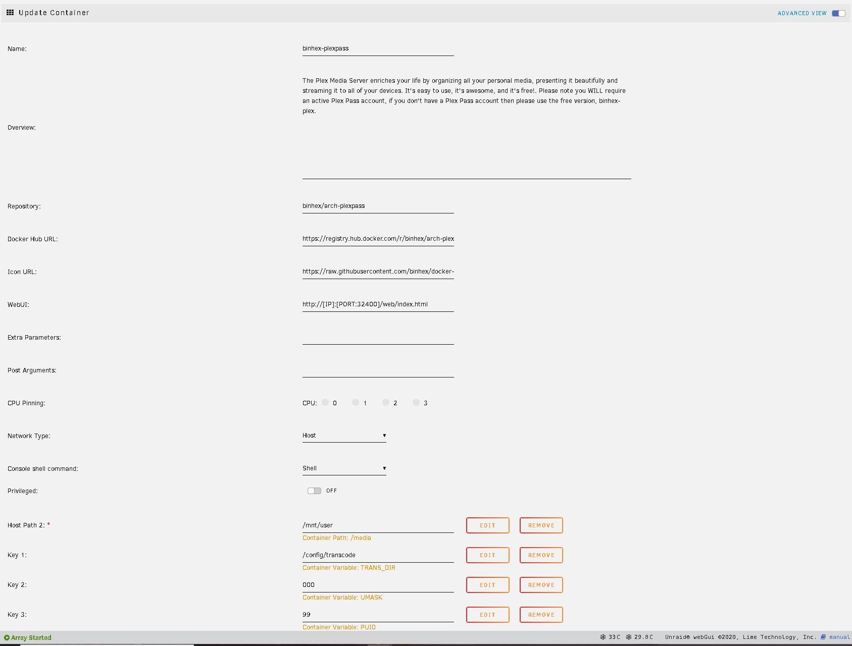

Switch to advanced view (top right).  There's probably an orphan there.  Delete it and plex again.  Then Apps - Previous Apps and reinstall

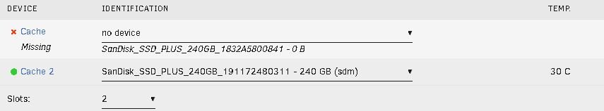

It's your cache pool causing you issues.  It appears to me that one of the members died / dropped offline @johnnie.black
Its funny you mention that i just ran a smart report on the drives as i can see the temp of 1 of the SSD's but not the other. I can get a smart report out of one but not the other. they are both mirrored so pulling/disabling one of the drives should solve this and replace drive? If its a dropped drive im not having much luck had a WD red fail on me a week ago and had to replace this.
hmmm im going with SSD failed. just stopped the array and now cannot see one of the SSD's to start the array i need to "stat will remove the missing cache disk and then bring the array online" will this cause any issues ?
It is always possible it dropped offline for some reason, and that power cycling the server will get it back.
And it's not the first time it dropped, see here for better pool monitoring.
Thanks Johnnie I am going to power cycle the server and see what happens. do you think one of the SSD's is going bad? they are not that old so i might get lucky with a warranty return if so
OK quick update, power cycled the server and the SSD has come back to life. the Docker has also successfully updated its self and unraid is reporting that cache disk has returned to normal operation. I would love to get to the bottom of this and replace a disk if needed

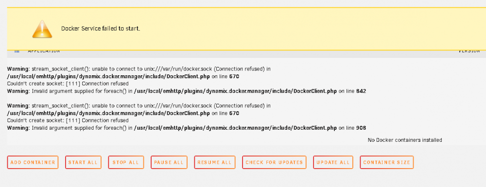

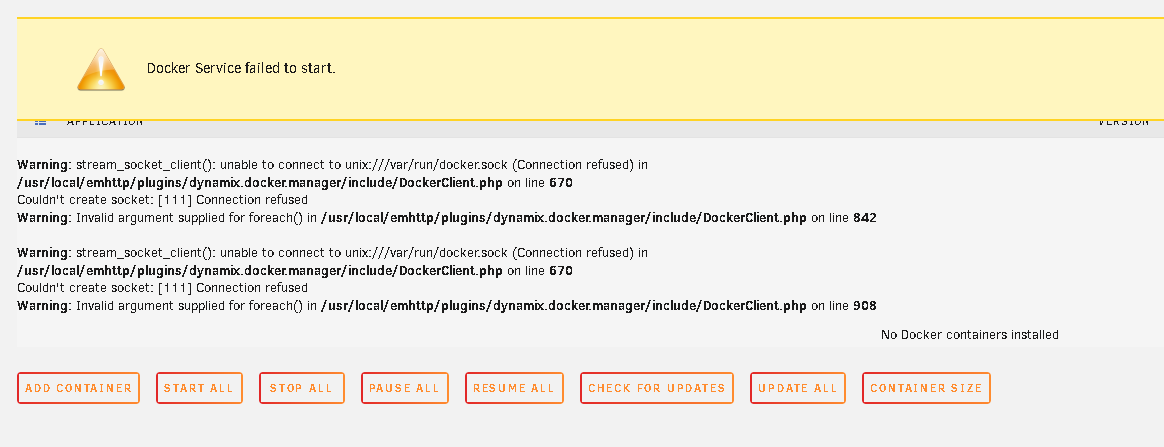

something is still not right. I just powered down my server checked all sata connections and powered back up. all drives are showing up fine but i got this ?
so i am trying to stop the array and its just saying Retry unmounting disk shares. I have lost all my dockers too image.thumb.png.d0707bb099a7a4e6b9a3ee4b01e17629.png
