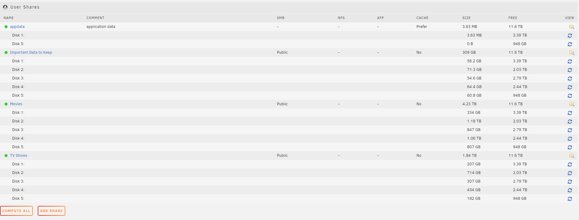

Below is a list of my shares:
The data on my cache drive looks like this:
The "For Picture Frame" folder can be disregarded.  The appdata share now has me completely confused because when I look at what data that corresponds to from the unraid menu it appears to be nothing but an older folder for an application that has since been deleted.  I originally thought the appdata share might correspond to the apps folder on the cache drive, but that doesn't appear to be the case.  Ultimately, I know I'm supposed to change any of the user shares I have on the cache to YES for USE CACHE, but from what I'm seeing is the appdata share doesn't corresponded to the data in the apps folder so it wouldn't even be moved.  Additionally, my docker.img file is sitting on the root of the cache drive as well so I guess that wouldn't get moved either.  Does this make sense?

From your prior posts, it appears your appdata share is on the array and not on the cache drive/pool.  Is there a reason for that?  Is your cache drive/pool an SSD?
In some cases, Mover can also be used in the cache drive replacement process or in moving certain shares (such as appdata, domains, etc.) from the array to the cache drive or vice versa.

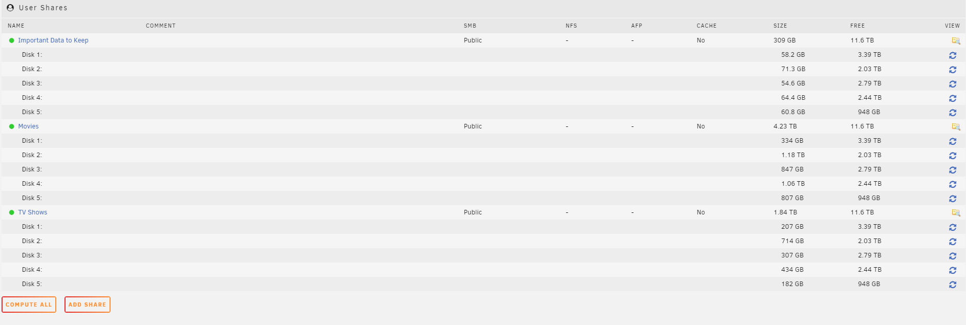

I think I installed a docker some time ago and it (or I) inadvertently had the docker create the share on the array.  Regardless, I just deleted it since I was pretty confident it was serving no purpose.  Now my user shares look like this:
Note that none of the shares are on the cache so I don't see how I could follow the instructions found here:  https://wiki.unraid.net/Replace_A_Cache_Drive
Specifically, I don't see that steps 3 and 4 apply to me.  Since I don't have any user shares on the cache drive then I am forced to move the apps folder containing my docker files and the docker.img file manually and then move it all back to the cache drive once the new drive has been installed and formatted.  Basically, invoking MOVER based on those instructions wouldn't do anything.  Does this sound right?

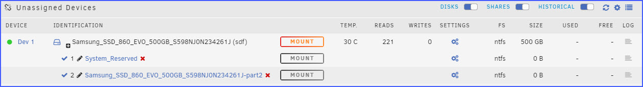

I finally got around to doing this and so far everything seems to have gone ok.  I'm at step 6. in my list where I need to format the newly installed cache drive.  However, there was no check box available for me to format it.  I think the problem is that I was using this drive in another PC and it was already an NTFS disk.  I did a little research and installed the UNASSIGNED DEVICES PLUS plugin because I thought I might need DESTRUCTIVE MODE enabled, but having that enabled still does not reflect a way to format the drive in Unassigned Devices so it can be used as a cache drive.
Any guidance here?  Should I possibly remove both of the partitions listed under the drive?  Again, I don't need any of the data on this drive.  I'm just looking to set it up as a cache drive and then have it rebuild the docker.img on it as I had on my previous cache drive.761060665_2021_06_11-0004.thumb.jpg.97c82e9aa87c1dac5c94ab6d09038d36.jpg
You need to assign the SSD to the Cache slot, per step 6 of your own instructions. It is currently unassigned.
Thanks John.  I actually did that, but I still didn't see an option to format the drive.  I needed to start the array.  Once I did that the option to format the drive came available.
This all seems to have worked, which is awesome.  The Previous Apps option and having your settings retained was so nice.  Thanks again.
