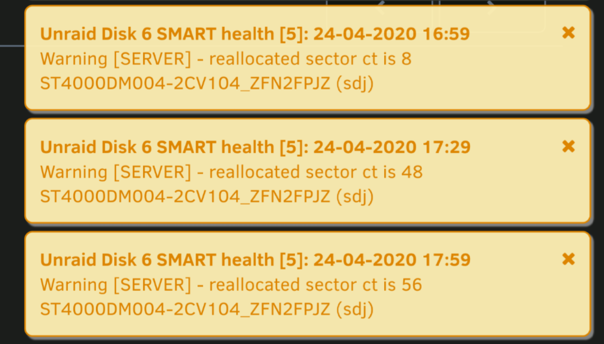

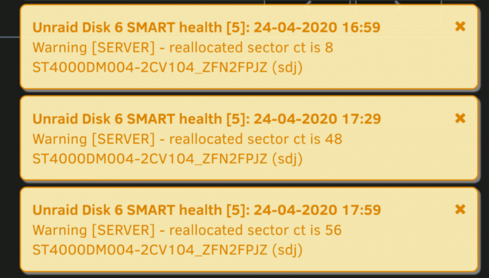

So the extended SMART test completed without error but as I was running it, I got these alerts where the reallocated sector count ran up to 56. Is that a sign of a faulty disc?
While reallocated sectors are not inherently bad, if the reallocated sector count is continuing to increase then that is a good indication that disk failure could be imminent.
Try running xfs_repair again, and if the reallocated sectors keep increasing you should consider replacing that disk.
