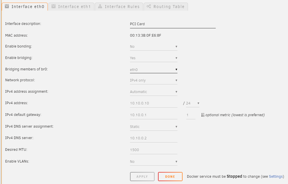

The Unraid server used 1 NIC, on the untagged VLAN, IP address of 10.10.0.10\.  Everything worked fine

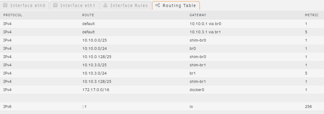

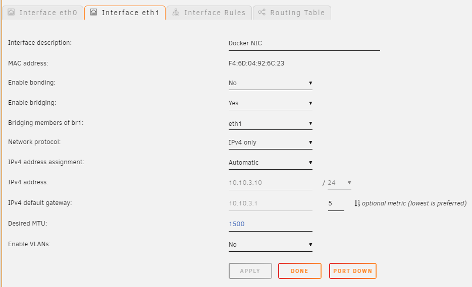

My goal was to use the 2nd server NIC, drop it onto the 130 VLAN (IP Address 10.10.3.10) and then have all the docker containers running off that NIC.
On the nw switch I allowed only the 130 VLAN to the 2nd NIC.  DHCP configured and it gets the desired 10.10.3.10 IP address.
I have 2 bridges setup.  br0 has some dockers, br1 the others.  This is mainly a transitional phase as I will move all to br1 when things are working fine.
First problem arises at this point.  My PCs can no longer resolve the Unraid server.  Previously tdm resolved as 10.10.0.10 and all was good.  Now tdm resolves to 10.10.3.10.  An additional issue that trying to ping 10.10.3.10 fails.  Only a local hosts file entry fixes this.  To reach the dockers I need use a reverse proxy as the IP addresses fail.
